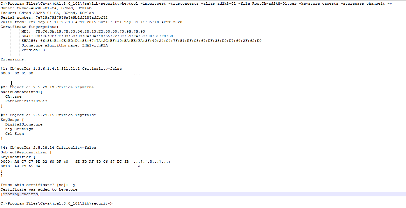

1. Add the CA cert which signed the SPS Apache server certificate to the java key store as trusted CA:
e.g. keytool -importcert -trustcacerts -alias ad2k8-01 -file RootCA-ad2k8-01.cer -keystore cacerts -storepass changeit -v

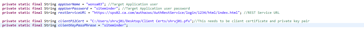

2. Modify the following properties in UserAuthenticationServiceImpl.java as per your environment
