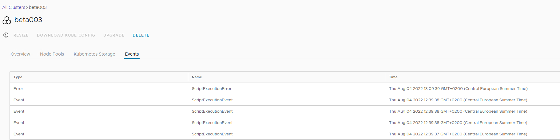

    The cluster creation never completed and the cluster never ready.
    Then vapp and vm are removed and recreated later in loop.

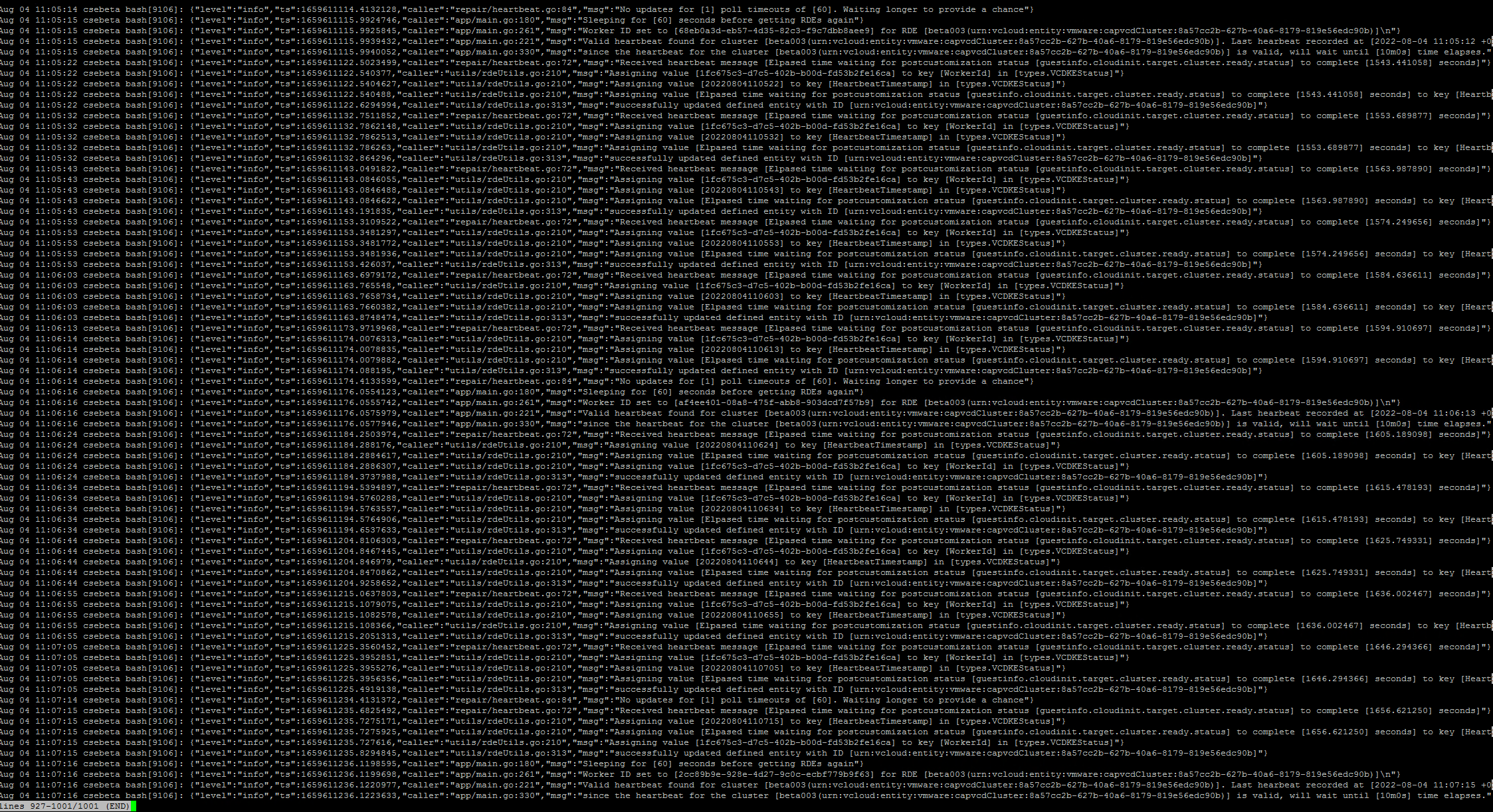

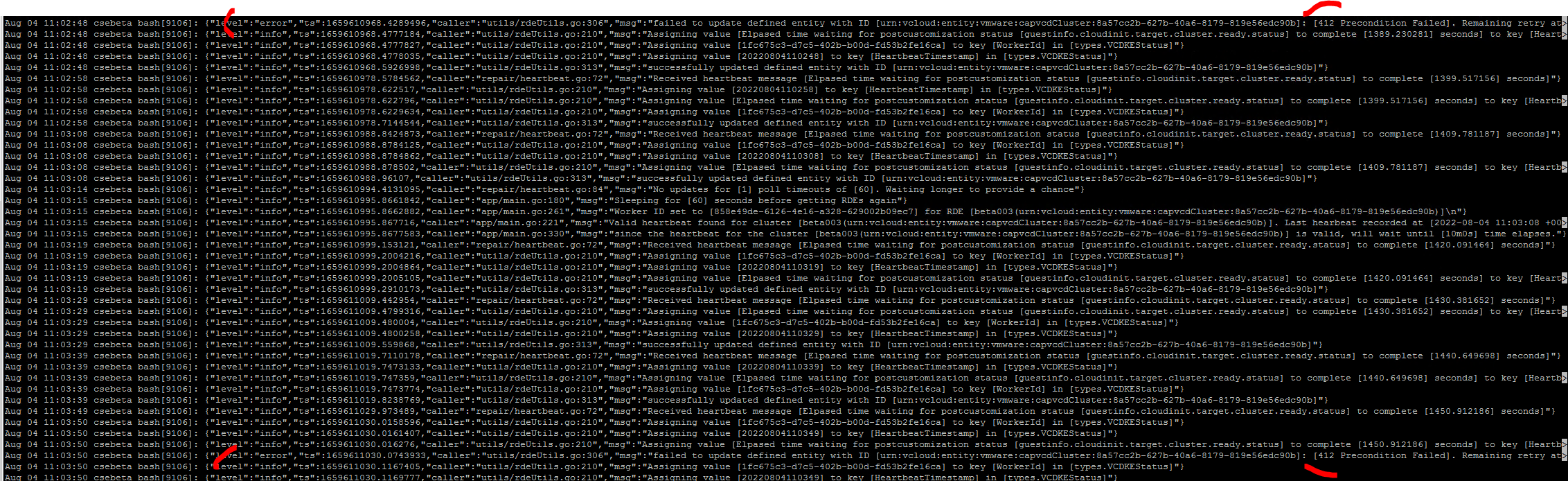

    Result of a "cat /var/log/cloud-final.err"
    Note: I am not sure if we can login as root with ssh, so screenshot is from the console

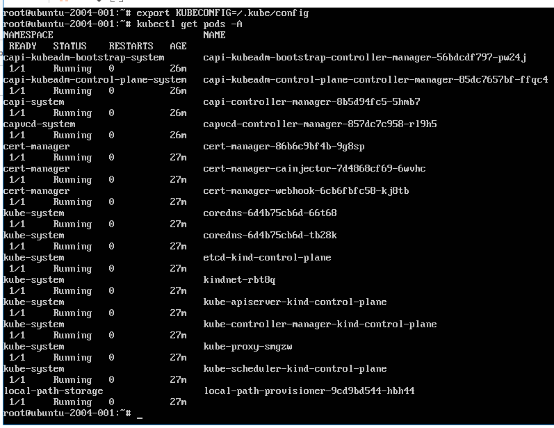

    All pods seems ok.
    And from the journal i don't see relevant error
    But few errors earlier of type "412 Precondition Failed"
    Seems the latest error in event then is associated to the event of deleting vapp and load balancer

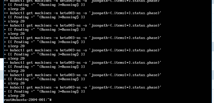

    Thank you for the reply.
    I can confirm that the "machine" is in pending state.

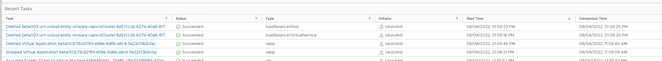

    I have also noticed pending task at the load balancer level.
    I do not know if they are at the origin of this issue or a symptom of it.
    No member in the pool so maybe they are not there because machine is in pending state, or the machine is in pending state because the pool doesn't have the members.

    thanks for the screenshots. Screenshots show Ephemeral vm has all pods up and running.
    But, it looks like the target machine objects are in pending state that is in a loop.
