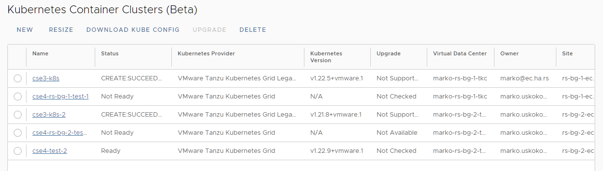

    I have tried CSE.next on multisite setup, where I have two VCD sites paired on system and organization level.
    So, sites are rs-bg-1-ec and rs-bg-2-ec and I can see VDCs and VMs from both sites in VCD.
    Also, in CSE UI plugin on rs-bg-2-ec site I can see k8s clusters from both sites:
    If I click on cse4-rs-bg-1-test-1 link, it will open rs-bg-1-ec site in new browser tab, but it will not accept my current SSO login and I will need to login again to manage my cluster. Annoyance, but bearable.

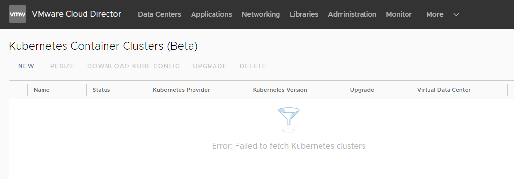

    The real problem is, if I login to rs-bg-2-ec site, and go to another site by SSO, and then open CSE UI plugin, it will not be able to show any clusters, it will display message "Error: Failed to fetch Kubernetes clusters"
    There is 401 Unauthorized HTTP request to rs-bg-1-ec site's /api/session url and there is a "CSE UI: Error fetching sites" message in browser console.

    I don't see any specific error, because it opens in new tab without inspect element so I can't track http requests. Will report if I find some error.
    When I login to rs-bg-2-ec site and want to go to another site by SSO I just click on site name in "Data Centers" -> "Virtual Data Center" like in picture attached

    If I login to rs-bg-2 and switch to rs-bg-1 site from the "Data centers" page of tenant portal, then I get "Error: Failed to fetch Kubernetes clusters" because of "401 Unauthorized" request to /api/session and the rezulting "CSE UI: Error fetching sites".
    Since this is evident even on CSE 3, should I open SR and debug it there and give VMware with screen sharing session so someone can better describe problem and collect what is going on?
