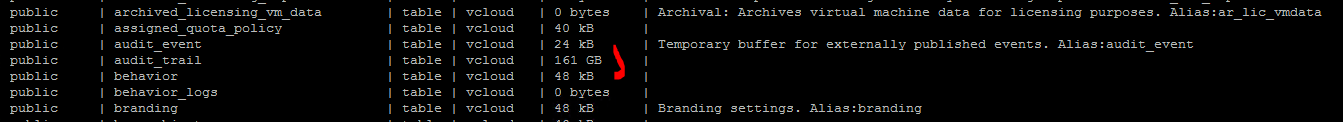

    I have a similar issue. vCloud director "database full".
    In my case the table "audit_trail" in the "vcloud" database in vCloud director postgres database is now 160 GB. Database size has been increased multiples time but this can't be the solution in long term vision.

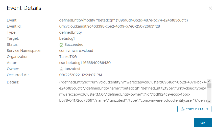

    But i think the ones consuming the largest amount of data are the events of type "definedEntity/modify ''beta006'' (9ebee87d-9d05-4c3f-b8e7-01ea477ac48c)"   - beta006 is one of the cluster create with CSE beta.
    Because the Details are very large. See attached file.

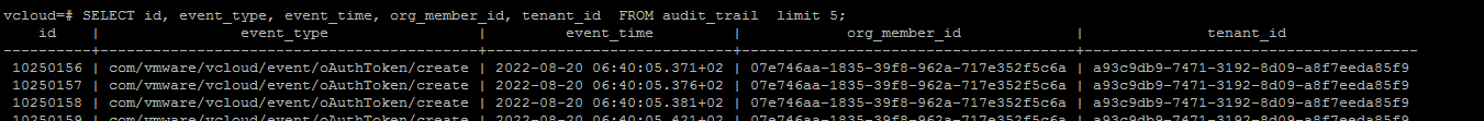

    Database: vcloud
    Table: audit_trail
    (I am wondering is this audit_trail is expected or maybe was due to previous troubleshooting on this cloud director instance, i don't have full control of history)

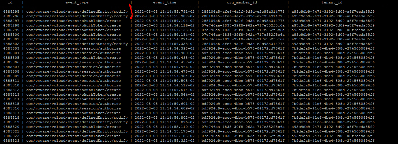

    The weird thing is if i look at the first rows they are always the same, they are never purged and therefore database grows in size.
    If i looks at latest row, (i have just build a new cluster)
    I see a lot of "modify" event, and i think there are the one filling the database because the payload is large. (I can't display it with the query, because it breaks all formatting)
    Example of such event
    (Details of a similar event could be seen attached to my previous post)
    My immediate concern is how to clean this database. Could i just run a query to remove the first  (oldest) 1000 rows for example?

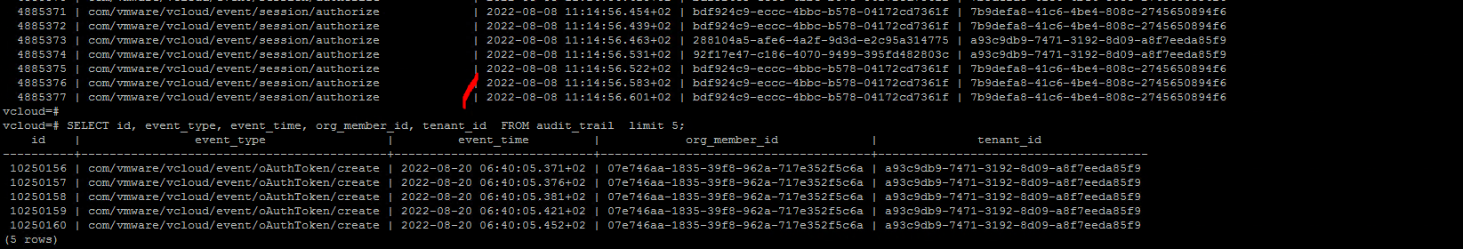

    Posted Sep 22, 2022 10:59 AM
    Update: Just discovered with another sql query that there are older logs in this table.
    So just using "limit 5" does not display the first entries.
    By using instead
    SELECT id, event_type, event_time, org_member_id, tenant_id FROM audit_trail ORDER BY event_time limit 100;
    i end up with the real first events, which seems already related to the beta. So maybe starting when the beta and clusters were first deployed.
  • 7.  RE: authorize every minute
    Broadcom Employee
    Posted Sep 22, 2022 07:24 PM
    select event_type, count(*) as num from audit_trail group by event_type order by num desc
    This should give you the aggregates without having to rely on limits, the query should be pretty fast. I can run the query in under 10 seconds on a 30GB db

    Posted Oct 04, 2022 01:15 PM
    Hi,
    I did manage to remove rows.
    However the table itself is still displayed at the same size.
    Could you please let me know what should be the next step?
