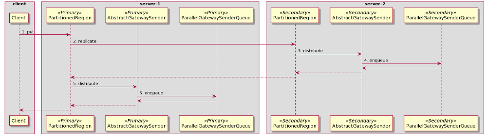

Normal Usage With Region Operations
Normally, events get delivered to AsyncEventsQueues as a result of Region operations like create, update and destroy. Here is a simplified diagram of that architecture:
Timing diagram illustrating distribution of data from a client to a primary server and then to a secondary server before client receives return value

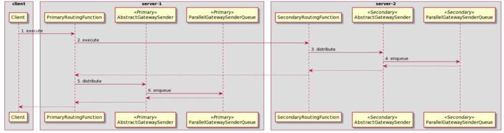

Usage With Function Invocations
An alternate architecture bypasses the Region operation and replication in the diagram above and instead uses Function invocations to route the data between the primary and redundant servers. Here is a simplified diagram of that architecture:
Timing diagram illustrating distribution of data using function invocations
