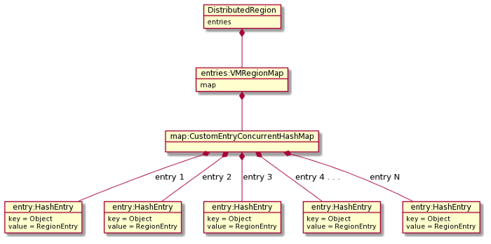

Replicated Region
A replicated Region is implemented by a DistributedRegion which contains a map of RegionEntries. Each RegionEntry contains the key and data value.
A simplified architecture is shown below:
Class Diagram For Distributed Region; CustomEntryConcurrentHashMap inherits from VMRegionMap which inherits from DistributedRegion

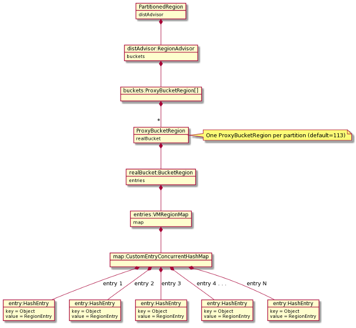

Partitioned Region
A partitioned Region is implemented by a PartitionedRegion which contains a collection of BucketRegions. A BucketRegion is an extension of DistributedRegion.
Class diagram for PartitionedRegion; PartitionedRegion contains RegionAdvisor which contains ProxyBucketRegions
