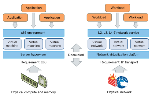

NSX network virtualization programmatically creates, snapshots, deletes, and restores software-based virtual networks. This transform the approach to networking for imporve agility, reduce operational cost and increase the security.  NSX is a completely non-disruptive solution: the physical network infrastructure you already have is all you need to deploy a software-defined data center.
With network virtualization, the functional equivalent of a network hypervisor reproduces the complete set of Layer 2 through Layer 7 networking services (for example, switching, routing, access control, firewalling, QoS, and load balancing) in software. As a result, these services can be programmatically assembled in any arbitrary combination, to produce unique, isolated virtual networks in a matter of seconds.
Unlike legacy architectures, virtual networks can be provisioned, changed, stored, deleted, and restored programmatically without reconfiguring the underlying physical hardware or topology.

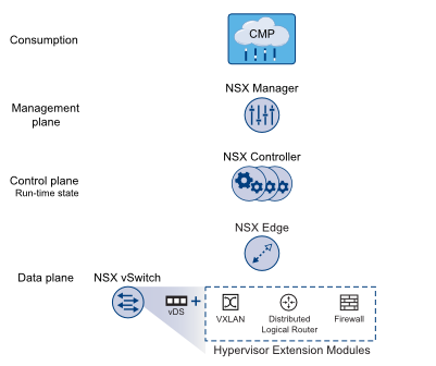

NSX Components
Data Plane
Consists of the NSX vSwitch, which is based on the vSphere Distributed Switch (VDS) with additional components to enable services:
  1. distributed routing
  2. logical firewall
  3. VXLAN
Control Plane
runs in the NSX Controller cluster which is an advanced distributed state management system that provides control plane functions for NSX logical switching and routing functions.
It maintains informations about:
  1. Hosts
  2. logical switches (VXLAN)
  3. distributed logical router (DLR)
It manages at hypervisor level:
  1. Distribute switching
  2. Routing
It must be resilient: must be deployed in a three-node cluster. The three virtual appliances provide, maintain, and update the state of all network functioning within the NSX domain (3 nodes to avid split-brain scenario)
A controller cluster has several roles, including:
  1. API provider
  2. Persistence server
  3. Switch manager
  4. Logical manager
  5. Directory server
Management Plane
Is built by the NSX Manager, the centralized network management component of NSX; it also provides the single point of configuration and REST API entry-points.
Is installed as a virtual appliance on any ESX host has a one-to-one relationship with vCenter (even in a cross-vCenter NSX environment)
Consuption Plane
Typically end users tie network virtualization to their cloud management platform for deploying applications. NSX provides rich integration into virtually any CMP through REST APIs. Out-of-the-box integration is also available through:
  • VMware vCloud Automation Center
  • vCloud Director
  • OpenStack with the Neutron plug-in for NSX.
NSX Edge
could be :
  1. NSX Edge as an edge services gateway (ESG): gives you access to all NSX Edge services such as firewall, NAT, DHCP, VPN, load balancing, and high availability and can install multiple ESG virtual appliances in a datacenter. It has a total of 10 uplinks and with a trunk could have up to 200 subinterface.
  2. distributed logical router (DLR): provides East-West distributed routing with tenant IP address space and data path isolation. It can have eight uplink interfaces and up to a thousand internal interfaces. It has 2 main components:
    1. The DLR control plane (virtual appliance called also control VM): supports dynamic routing protocols (BGP and OSPF), exchanges routing updates with the next Layer 3 hop device.
    2. DLR kernel modules (VIBs) that are installed on the ESXi hosts that are part of the NSX domain similar to the line cards in a modular chassis supporting Layer 3 routing. Have a routing information base (RIB)

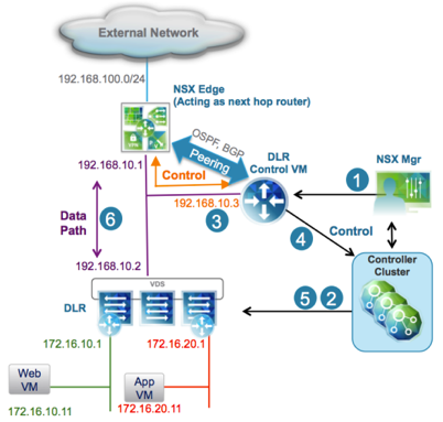

Logical Routing Mechanism
  1. NSX Manager UI (or with API calls): creates a DLR istance and routing is enabled, leveraging either OSPF or BGP.
  2. The NSX Controller: leverages the control plane with the ESXi hosts to push the new DLR configuration including LIFs and their associated IP and vMAC addresses.
  3. Assuming a routing protocol is also enabled on the next-hop device (an NSX Edge [ESG] in this example), OSPF or BGP peering is established between the ESG and the DLR control VM. The ESG and the DLR can then exchange routing information:
    • The DLR control VM can be configured to redistribute into OSPF the IP prefixes for all the connected logical networks (172.16.10.0/24 and 172.16.20.0/24 in this example). As a consequence, it then pushes those route advertisements to the NSX Edge. Notice that the next hop for those prefixes is not the IP address assigned to the control VM (192.168.10.3) but the IP address identifying the data-plane component of the DLR (192.168.10.2). The former is called the DLR "protocol address," whereas the latter is the "forwarding address."
    • The NSX Edge pushes to the control VM the prefixes to reach IP networks in the external network. In most scenarios, a single default route is likely to be sent by the NSX Edge, because it represents the single point of exit toward the physical network infrastructure.
  4. The DLR control VM pushes the IP routes learned from the NSX Edge to the controller cluster.
  5. The controller cluster is responsible for distributing routes learned from the DLR control VM to the hypervisors. Each controller node in the cluster takes responsibility of distributing the information for a particular logical router instance. In a deployment where there are multiple logical router instances deployed, the load is distributed across the controller nodes. A separate logical router instance is usually associated with each deployed tenant.
  6. The DLR routing kernel modules on the hosts handle the data-path traffic for communication to the external network by way of the NSX Edge.
