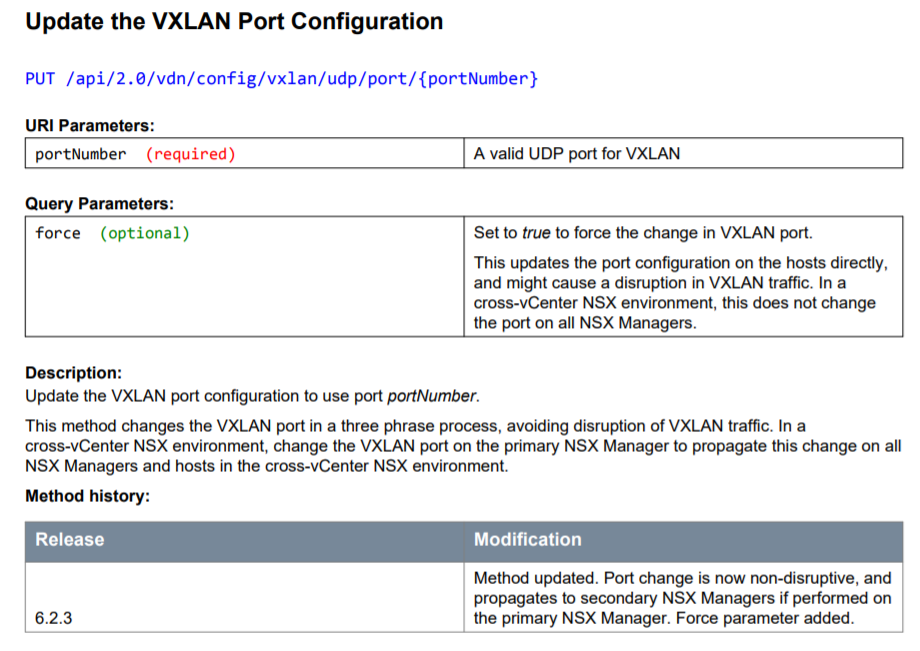

    Based on the NSX admin guide and API Guide, the VXLAN port configuration is per NSX Manager whether it is via UI or via REST API
    Change VXLAN Port
    https://docs.vmware.com/en/VMware-NSX-for-vSphere/6.3/nsx_63_api.pdf
    The default in 6.2.2 is 8472 and default after 6.2.3 is 4789 same with standard VXLAN IANA port.
    Just curious, why would you like to change it back to 8472?
    I haven't try this but this blog says (which I believe this is relevant prior NSX 6.2.3) it would disrupt the data plane.
    After 6.2.3 should not disrupt data plane per admin guide and API guide, see above screenshot there's a mention of "this method changes the VXLAN port in three phase process, avoiding disruption of VXLAN traffic"
