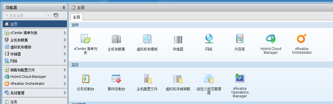

    I tried the exactly same steps as you showed but I can't see "network & security" tab in vcenter web client even I logout and login again.

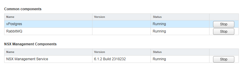

    2. all service is running on NSX:

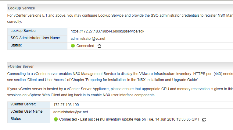

    3. NSX has regiestered to lookup service and Vcenter correctly:
    but I can find "network & security" tab in vcenter web client even I logout and login again:
    I'm so confused with that result because I did every step as the VMware doc said and has all service work fine.

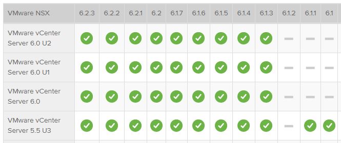

    The plug-in will not show up.  NSX 6.1.2 is not supported with vCenter 6.0.  Support for vCenter 6.0 begins with 6.1.3.  A screenshot from the product interoperability matrix is shown below:

    Hi  Iarsonm,
    Great, you're my hero.
    With NSX Manager 6.2.2, everything is fine now.
    Thanks very much.
    Mike
