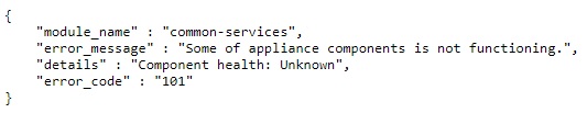

    i deployed a nsx-t 2.4 manager on KVM with "medium" type, it worked just fine until i installed second manager(on another KVM host) and join it to the first one.
    they all display the following messages on the web browser after i type in the admin account and password to login, as shown below:
    i could not figure out why this error happen and it just can't be fixed after i restart services such as "ui-service" in the manager or even reboot the manager.
    does anyone know why? the "manager.log" and "syslog" in the manager appliance did not show messages which is truly helpful.

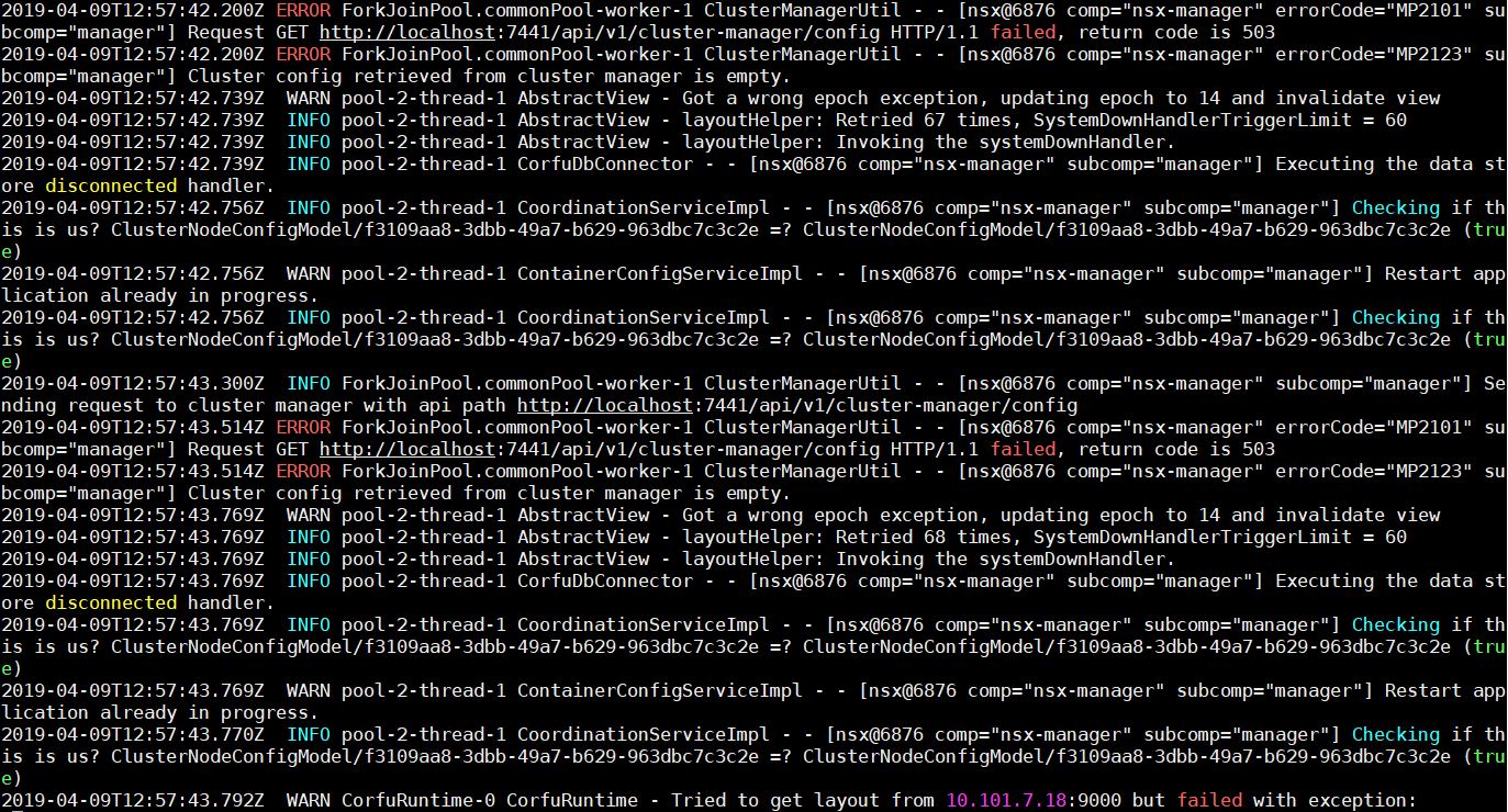

    in the primary manager, I used the command "get log-file" to retrieve messages,
    the messages in syslog is shown below:
    the messages in manager.log is shown below:
    napi.root.cluster.cbm_response WARNING Connection to cbm refused or timed out: 111
    and the messages in auth.log is shown below, approximately:
    i guess these information only help a little bit on troubleshooting this error-code-101 issue ?
