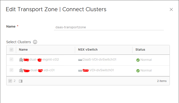

    Yes, i think you can do that. We have similar setup.
    You need to have 2 clusters. (in our case we have a management cluster and a vdi cluster. Both running their own dvs.
    You can connect a cluster to the transport zone. It might be wise to use the same vtep-network-ip-subnet for it (if you have enough ips free in it)
