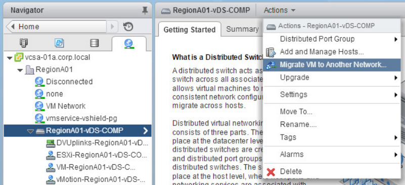

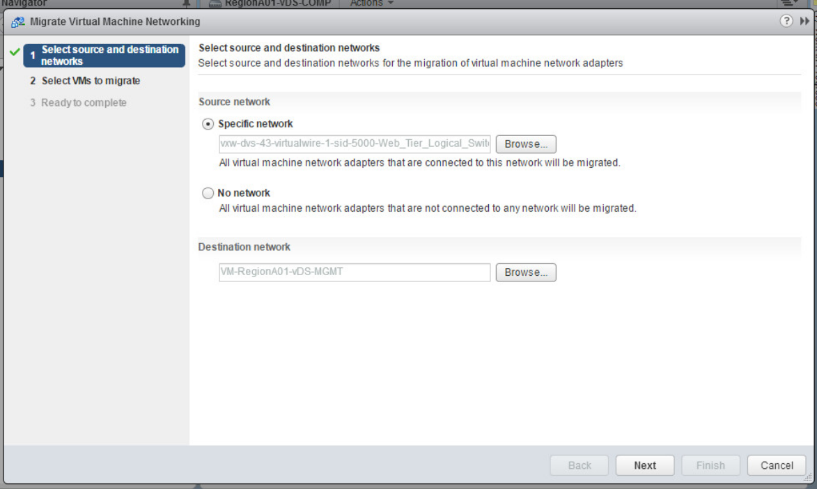

  • 8.  RE: Migrating from work load from VXLAN to VLAN
    Best Answer
    Posted Feb 01, 2017 06:32 PM
    Yes migration in this case = migrate network which is changing VM portgroup from VXLAN logical switch to PortGroup
    If you need to change the ESXi host, in vSphere 6 you can change ESXi and network in the same time
    You can use vSphere Web Client > Networking > VDS Migrate VM or use PowerCLI so you can migrate multiple VMs at a time
    vSphere Web Client: Migrate Virtual Machine Networking to the vSphere Distributed Switch
    PowerCLI: Migrate Virtual Machine Networking Configuration from a vSphere Standard Switch to a vSphere Distributed Switch
