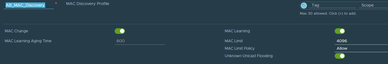

    Posted May 26, 2021 02:50 PM
    Yes I did. Here are my settings for the segment profile
