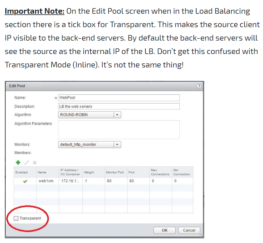

  • 6.  RE: “Insert X-Forwarded-For HTTP header”
    Posted Jul 14, 2018 01:40 PM
      You explanation is very helpful. For those who are little confused about "Transparent", Dimitri is referring "Transparent" as a mode (in-line = two armed). I believe original question was related to transparent tick box on the pool, not mode.
      I do not know if transparent tick box is a requirement for in-line.
