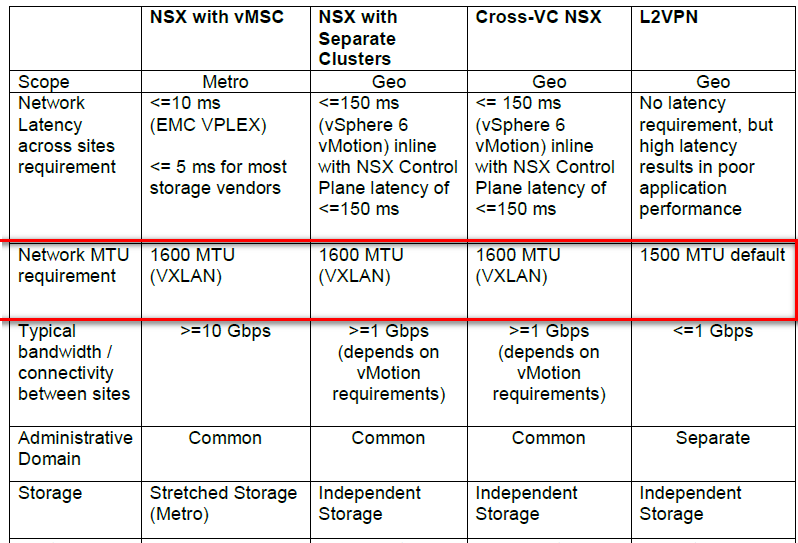

    Below is the recommendation from VMware regarding the MTU sizing
    Your normal ping packet size is between 32 ~ 56 bytes depending on the type of O.S, so you don't observe any issue.
    During normal data transfer, the packet size will be 1500 bytes. To this additional bytes will be added to the header. (VXLAN header)
    So its recommended to have the MTU size to 1600 bytes to avoid any packets getting dropped.

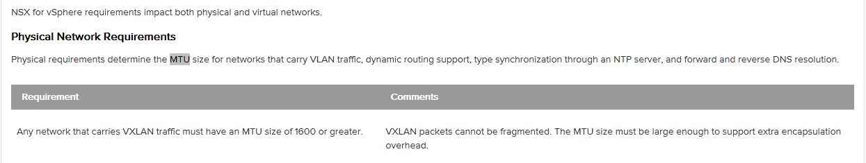

    The main point to consider here is that the VXLAN packets cannot be fragmented.
    That is the reason always ensure that the MTU is set to 1600 bytes.

    Rajeev is correct, 1600 is required, and to add since you asked, it will be end to end from VTEP to VTEP and everything in between.
