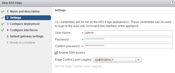

    Hi,
    It's the NSX Edge you enable SSH on. I wouldn't recommend enabling SSH, mostly because you create a new attack vector in your network. Troubleshooting and showing load balancer stats, can also be done from the Central CLI: NSX Central CLI for Operations & Troubleshooting
    But, if you want to, you can do this at the time of deployment, by enabling "Enable SSH access" in the wizard.
    https://docs.vmware.com/en/VMware-NSX-for-vSphere/6.4/com.vmware.nsx.troubleshooting.doc/images/GUID-FDA3C5A4-070F-4F3A-9430-26900D8406F8-low.png
    Manual: New NSX Edge (DLR)

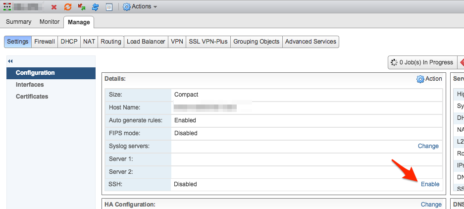

    Or when the Edge already has been deployed, enable it through the settings:
