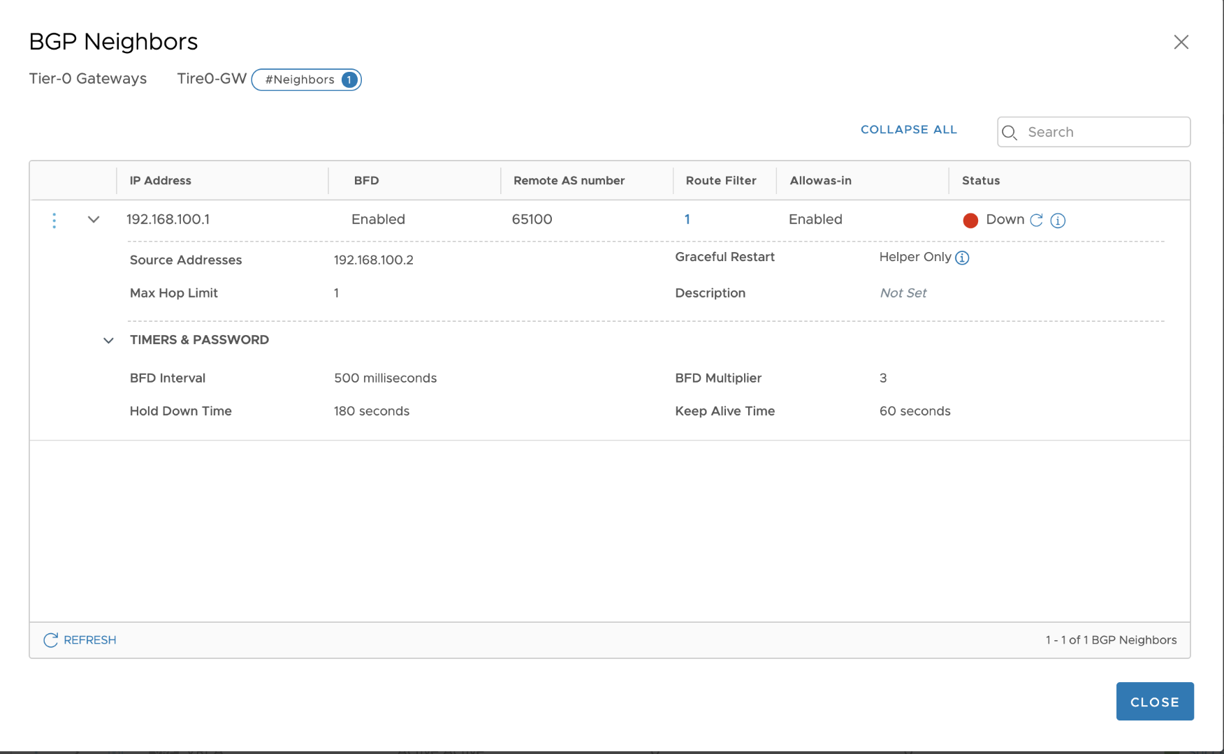

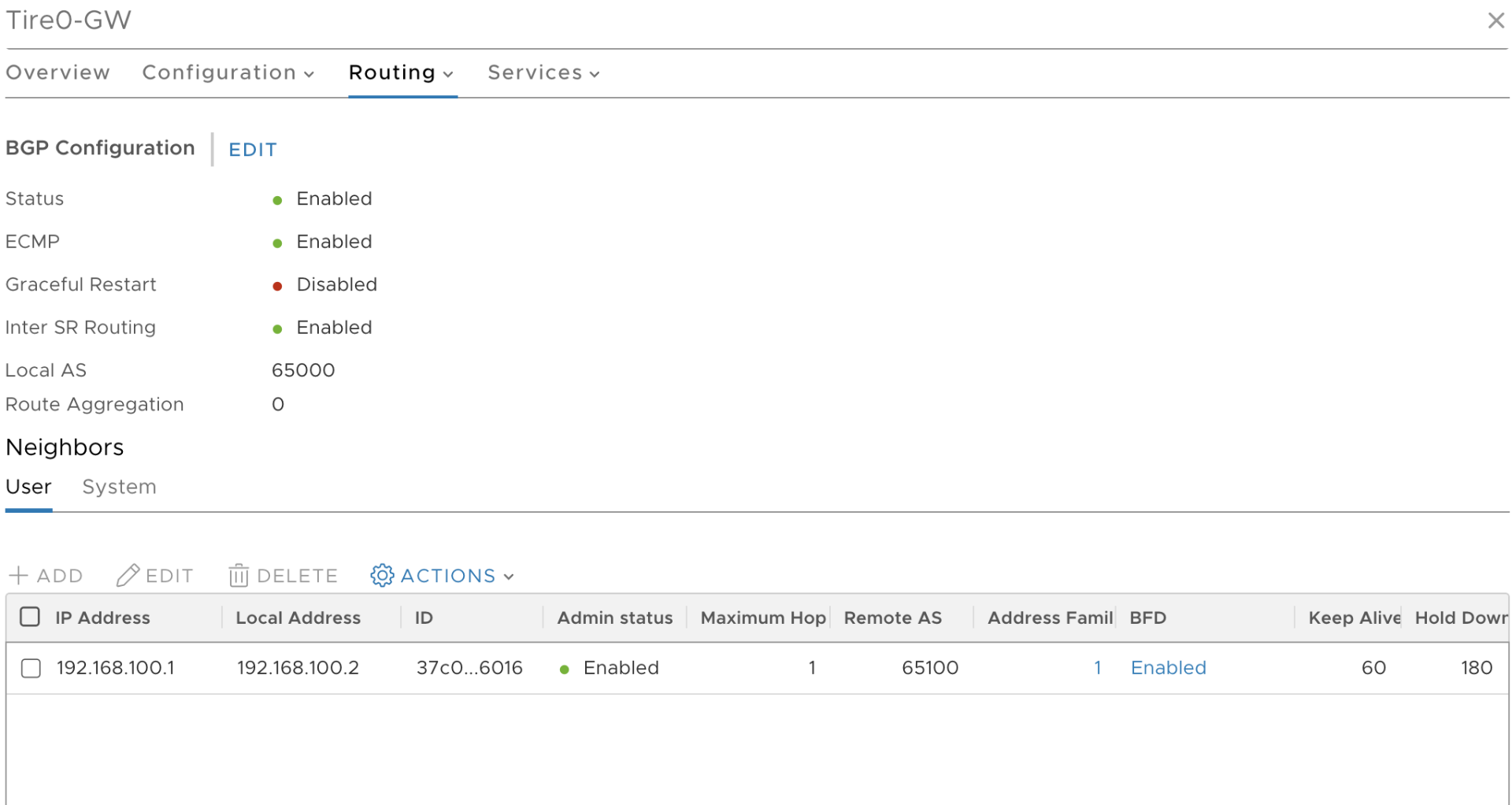

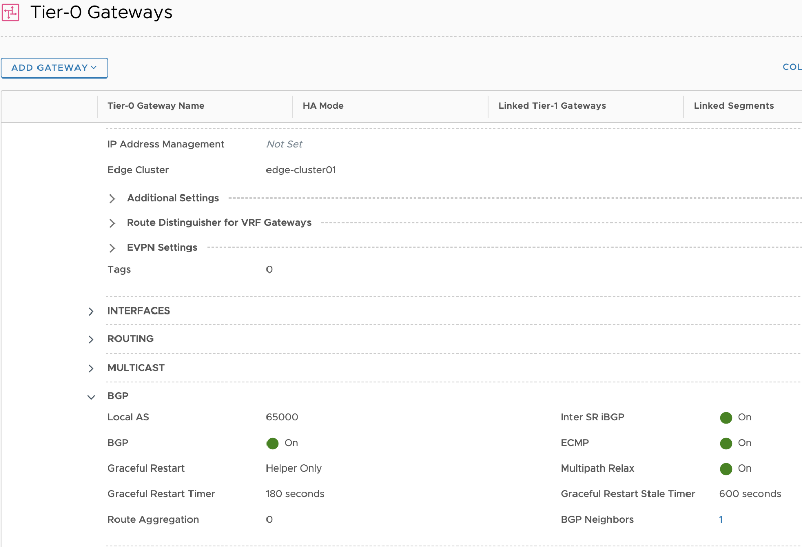

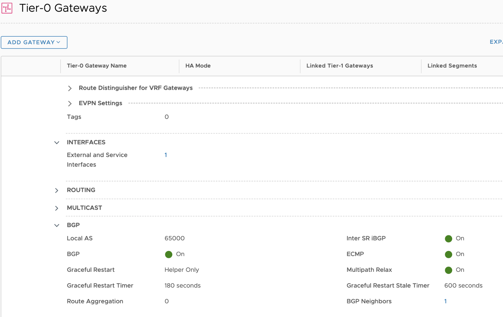

    Even after enabling BGP on UI on Tire0 Gateway, still on the CLI, it shows as BGP as "Administratively shut down".
    I am able to ping neighbor address from nsxt-edge1(tier0_sr). Only BGP shows as "Administratively shut down"
    Can anyone pls let me know, how to fix this?
    Tire-1 gateway is working fine.

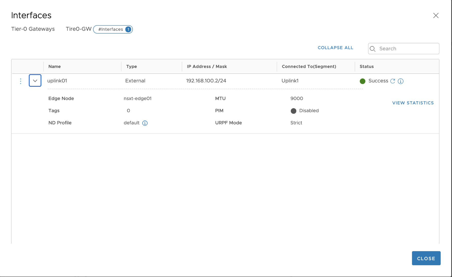

    Can you perform a BGP debug on both the routers ?
    Also please provide get interfaces output from tier-0
  • 3.  RE: Even after enabling BGP on UI on Tire0-GW, still on the CLI, it shows as BGP as "Administratively shut down".
    Posted Jul 10, 2020 07:46 PM
    Thanks for the reply. Pls find the details of get interfaces....
    On the other end (router), i did the debug, actually, it is establishing TCP connection and the other end, sends the BGP-OPEN message, then NSX sends TCP reset message...
    Other end (router) is trying to establishing the TCP and sending BGP OPEN message, but NSX-T send TCP reset message, and not sending any BGP OPEN message...
    its is like there is not BGP configured on NSX-T tire-0 gateway... On tire-0 it shows as "Administratively shutdown" , even with BGP enabled on UI...
    On NSX-T, Snippet of the uplink interface, where BGP connection trying to establish:

    If possible please share the screenshots of Interface and BGP config from U.I as well.
  • 7.  RE: Even after enabling BGP on UI on Tire0-GW, still on the CLI, it shows as BGP as "Administratively shut down".
    Posted Jul 13, 2020 05:50 PM
    Thanks for looking into this issue... Please find the details below:
    Note: I tried with BFD enabled and disabled, in both case, BGP neighbor shows as "Administratively shut down"
    With different VIew:

    There is an option to administratively disable a BGP neighbor and it seems that it was switched on. This is the only way I found to reproduce what you have. This switch is only available in the Advanced Networking and Security (NSX 2.5 and below) or on Manager mode on NSX-T 3.0+.
    The steps below were tested on NSX-T 3.0:
    If you do not have the Policy/Manager button in the upper right corner go to System > User Interface Settings (Last option) and Toggle Visibility so that it appears.
    Then go to Networking (click and make sure the Manager option in the upper right corner is selected)
    Click on Tier-0 Logical Routers > Click on the T0
    Under Routing > BGP > select the neighbor in the lower part of the screen and click on EDIT
    There will be an option to change de Admin Status > Change to enable
    Hope this helps
  • 11.  RE: Even after enabling BGP on UI on Tire0-GW, still on the CLI, it shows as BGP as "Administratively shut down".
    Posted Jul 14, 2020 10:41 PM
    Thanks for looking into this issue... yeah, i have verified the same on UI and the BGP neighbor admin-status is "Enabled:... Still no luck... on the CLI it shows BGP "Administratively shutdown"...
    Does this related to any physical NIC supportablility? I tried with both 10G and 1G physical NIC too...
    But, i am able to successfully ping between the neighbor router and Tire-0 interface.
