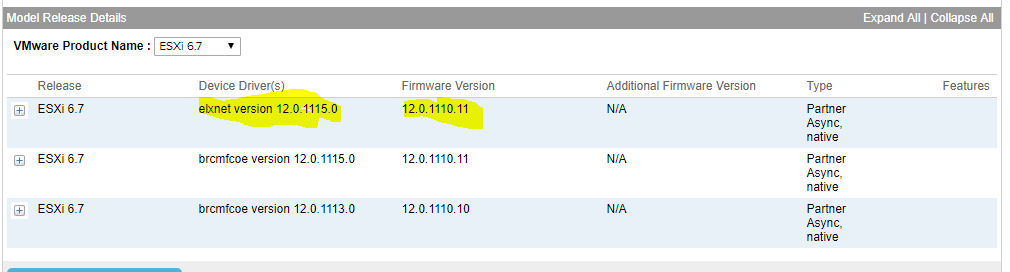

  • 3.  RE: esxcli network nic get -n vmnic0
    Posted Aug 08, 2018 09:11 PM
    You should be ensuring your driver/firmware is at the latest recommended combination.
    Use the link: VMware Compatibility Guide - I/O Device Search
    Example:
    Please consider marking this answer "correct" or "helpful" if you think your question have been answered correctly.
