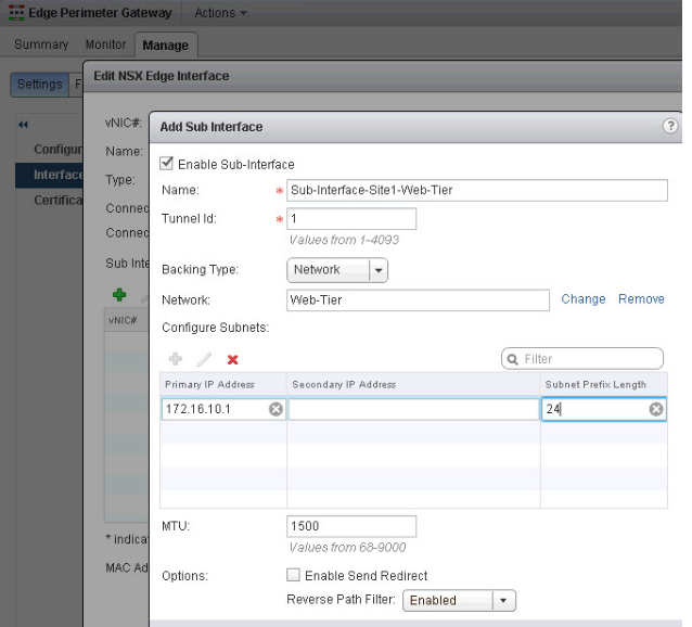

    WRT to your question on publishing networks to the Edge…The ESG can route Logical Switches, just follow this doc Add a Sub Interface.  You will set the “Backing Type” to “Network” and select the LS.

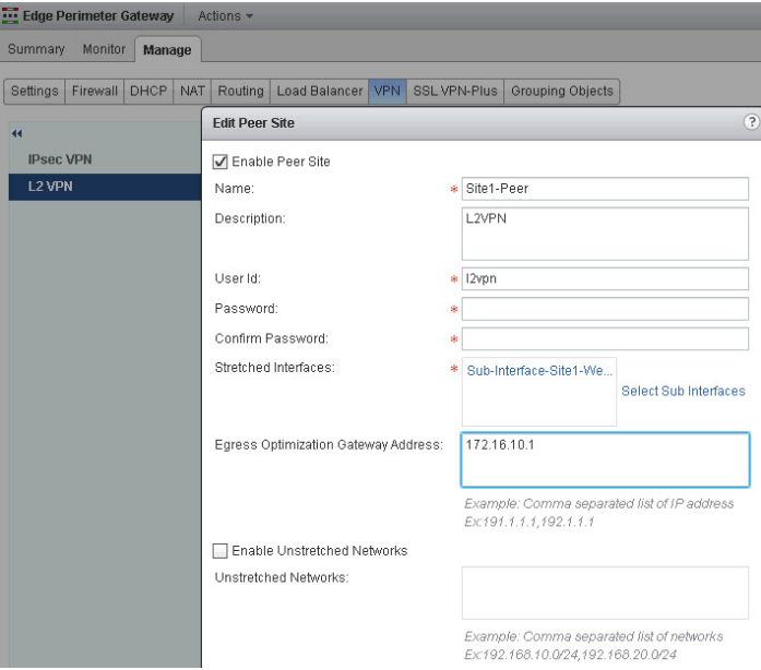

    As addition Egress Optimization may be helpful similar to Local Egress on UDLR

    Egress Optimization for L2VPN allows the  same default gateway to reside on both L2VPN Server Edge  on Site1 and L2VPN Client Edge on Site2. In that case, similar to  Site1, the L2VPN Client Edge may use ospf with Site2 Mpls router Northbound, and Site2 UDLR Control VM Southbound. In that case announcing /32 VM IP addresses (Since they may exist on Site1 or Site2) for Symmetric traffic may be necessary for symmetrical Ingress on Site1 and 2.

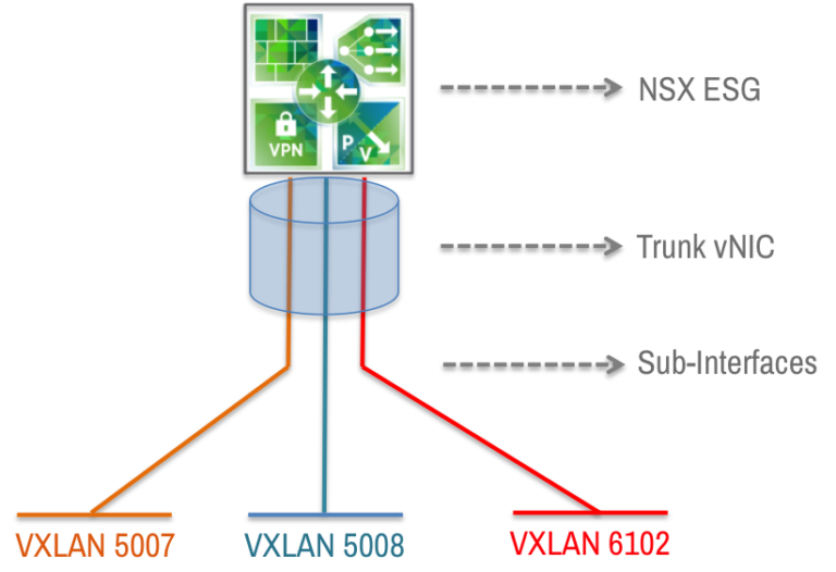

    These links may be helpful about  publishing routes for L2VPN Subnets and Configuring Trunk Interfaces:
    http://blog.ipcraft.net/nsx-edge-service-gateway-esg-trunk-interface/
    Step 1. Create a Port Group for Trunk Interface
    First, I need to create a port group on the vSphere virtual switch. This can be a standard or distributed port group and it will be associated to NSX ESG Trunk interface later. I prefer to use distributed port group as I do not need to manually create the port group on every hosts if I have more than one ESXi hosts.

    Local Egress Optimization: this is more easy to understand. It enables the ESG to route any packets sent towards the Egress Optimization IP address locally, and send everything else over the tunnel. Why? VM Mobility! If the default gateway for the virtual machines (belonging to the subnets you’re stretching) is same across the two sites you need this setting to ensure traffic will be locally routed on each site. Should you need to migrate VM from one site to the other, you can do so without touching the guest os network configuration.
    http://raoconnor.com/nsx/nsx-lab-configure-layer-2-vpn/
    Egress Optimization ensures traffic will use the local site edge
    https://www.vmware.com/content/dam/digitalmarketing/vmware/en/pdf/vcat/vmware-customer-onboarding-with-nsx-l2vpn-services.pdf
    For implementations that require workloads on the extended segment located within the VMware Cloud Provider to access the Internet, egress optimization can be enabled on the NSX Edge appliances with an egress optimization IP address. Typically, this is the same IP address as the default gateway that is used for the on-premises network being extended to the VMware Cloud Provider. Enabling this feature allows Internet bound traffic on the provider side of the connection to exit (egress) through the local egress optimization gateway instead of sending the traffic back over the extended network link to the Internet and then back across the extended link. The egress optimization feature is intended to be used to allow extended workloads to access the Internet or other networks within the VMware Cloud Provider’s environment.
