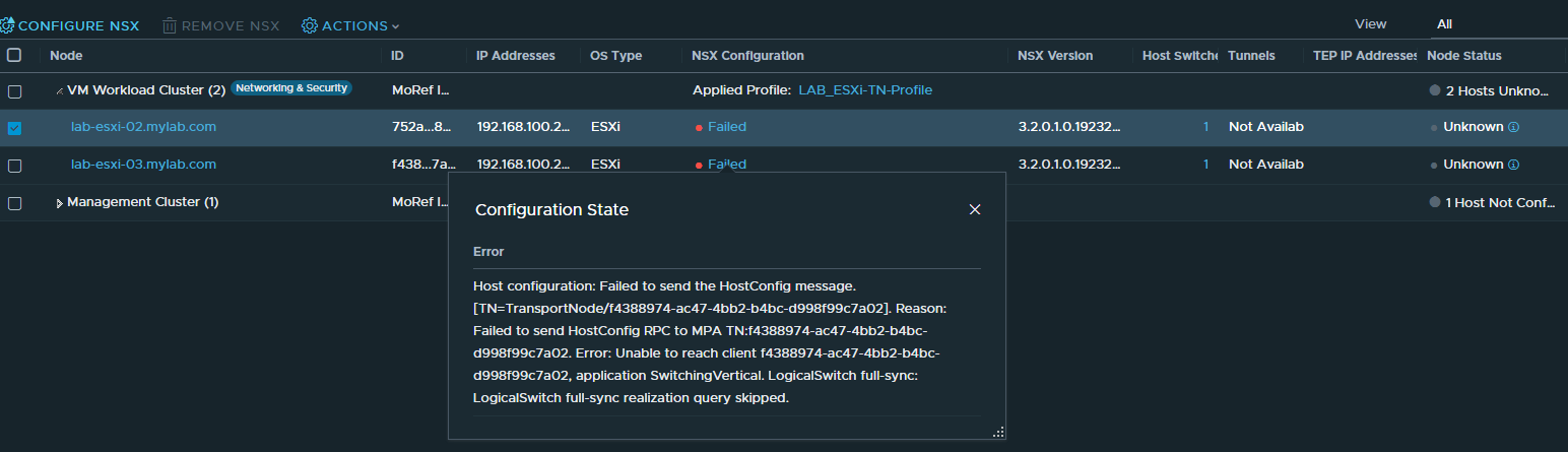

    I have a 2 node cluster in a nested environment, and whenever I try to configure the hosts for NSX i get this error :
     Host configuration: Failed to send the HostConfig message. [TN=TransportNode/3a82b3c5-1dc3-49cd-b72a-65e4cf5546ed]. Reason: Failed to send HostConfig RPC to MPA TN:3a82b3c5-1dc3-49cd-b72a-65e4cf5546ed. Error: Unable to reach client 3a82b3c5-1dc3-49cd-b72a-65e4cf5546ed, application SwitchingVertical. LogicalSwitch full-sync: LogicalSwitch full-sync realization query skipped.
    Anyone ever had this ? Thanks for reading

    Hi all,
    Problem resolved.
    The memory of the ESXi host need to be minimum 16GB.
    https://docs.vmware.com/en/VMware-NSX-T-Data-Center/3.1/installation/GUID-AECA2EE0-90FC-48C4-8EDB-66517ACFE415.html
    Due to my nested lab had limited memory I set the ESXi host (transport node) memory to only 8GB.
    Actually the host is not utilize even 20% of memory as I only loaded with 2 VMs (tiny linux) per host.
    8GB memory ,It failed with many error message, and end up totaly failed to prepare ESXi host as TN.
    After I changed the memory of ESXi host to 16GB , the configration/installation  of ESXI as TN went smoothly and sucessfully.
    The ESXI host need to have 16GB memory as stated in document to comply with the NSX-T 3.1 for transport node configuration/installtion process.
    p/s: after sucessfully configure NSX on host transport node , I change the node memory back to 8GB & 12GB to test it actual requirement. It work perfectly with 12GB but failed  with 8GB ( it went to power off state).
    ESXi host with NSX-T , the memory resouce is 16GB . Not include the VMs resource.
