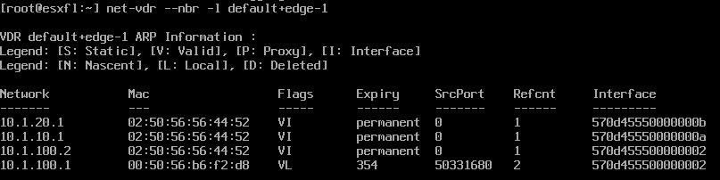

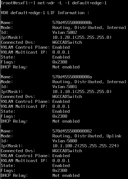

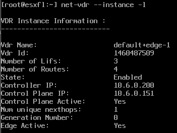

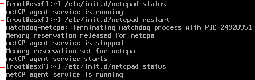

    First, I was applying the commands in the wrong device (something like barking up the wrong tree) but like I said before I'm a rookie and I'm allowed to make stupid mistakes (haha :smileyhappy:) . Now following some of your directions and chanaka_ek‌ blog's instructions I was able to verify the netcpa daemon, some screenshots here:
    also
    & finally
    So everything here looks fine, it is consistent with the deployment I'm trying to accomplish.

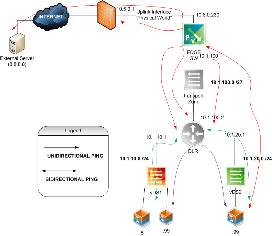

    I took the task to graphically show you where exactly I'm having the communication issues.
    As you can see (from TOP to BOTTOM)
    The Edge GW can communicate to the VMs in the inside part as well as the 3 DLR's interfaces. And also with the outside world (Internet). So I guess no problem there.
    Then the DLR can ping the VMs but cannot communicate with the Edge Gw through the transport zone.
    And finally but not least, the most strange behavior is with the VMs; where they can Ping each other (through the DLR), can ping the DLR's interfaces and even the Edge Gw's interfaces (both), but cannot go throughout the Edge Gw to the outside world.
    Any ideas, suggestions ??

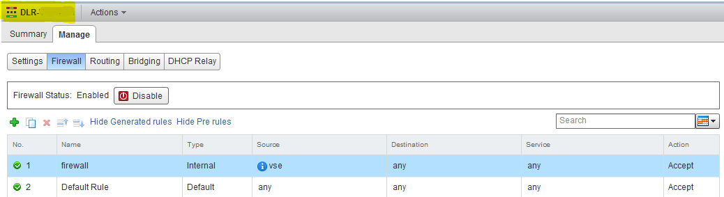

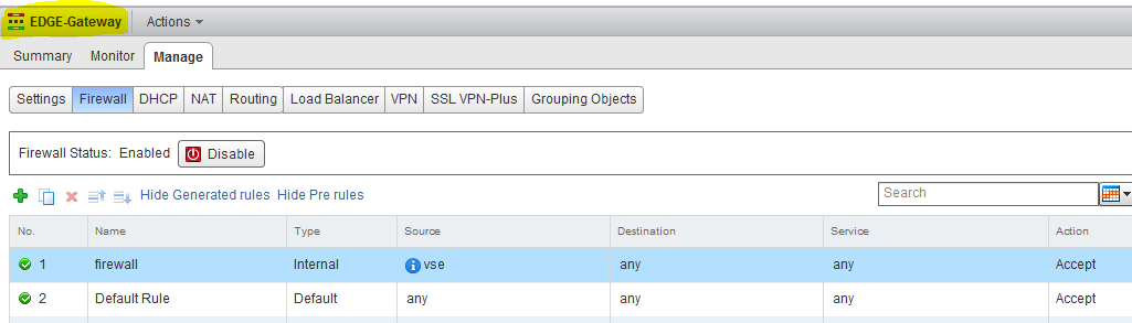

    • Firewall: I didn't disable it, I just added an "any accept" traffic rule:

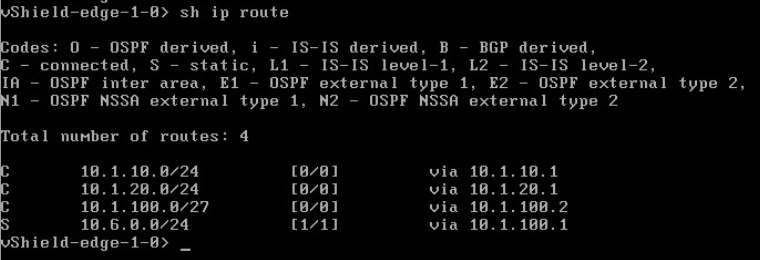

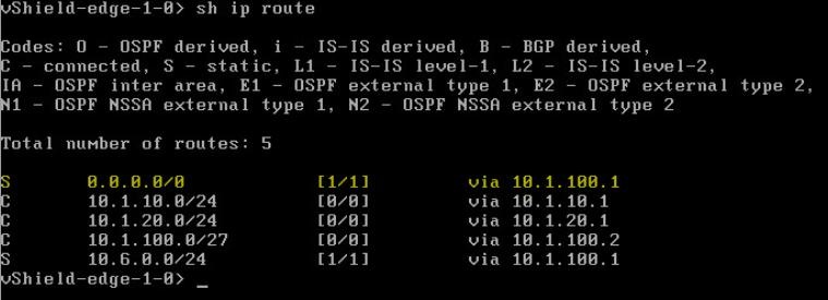

    • IP route table: I'm going with static routing:

    • Firewall: "any any accept" rule.
    • IP route table: statics

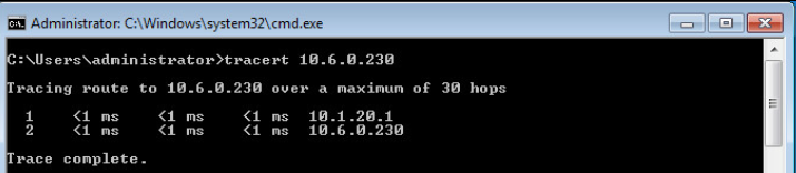

    • tracert from VM to EDGE GW (to the uplink interface of the EDGE gw):

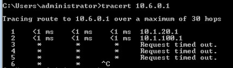

    • tracert from VM to the perimeter firewall:

    ‌From the routing table of the DLR, it has no default route, but only a static route for 10.6.0.0. So DLR (so the VMs) can't reach beyond 10.6.0.0/24 outside. If the VMs can also ping 10.6.0.1 and they have and Perimeter FW has static routes for VM subnets to .230, as well NAT, then lack of DLR default route towards EDGE (10.1.100.1) may be the issue.

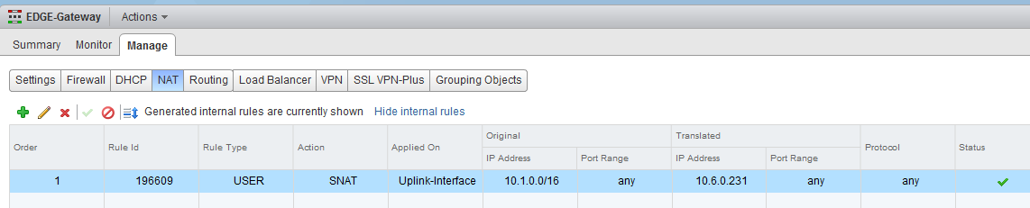

    And second was the missing EDGE's SourceNAT rule (thanks chanaka_ek‌)
    Combined, both missing configurations resolved all the communication issues.
