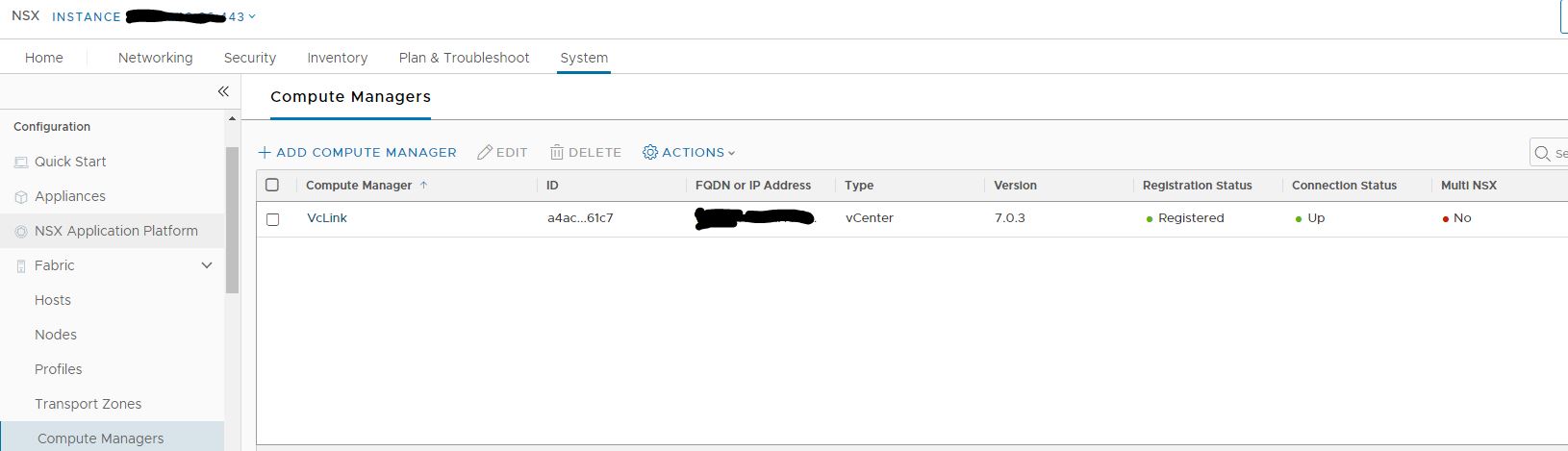

    There is only one Compute Manager from which NSX-T was deployed. I've used "Large" deployment typesnap.JPG.

    Yes, it's a 3-node cluster.
    I've tried to add the second compute manager from the vCenter plug-in and directly from the nsx-t node with the same result.

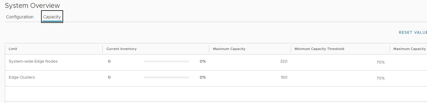

    Please check under System > System Overview in the Capacity tab how many Compute Managers are supported. In my demo it was deployed as Medium and i have a 2 system capacity.
    I encountered the same error as you and could only add the second vCenter by deleting the VcLink Computer Manager. After that I added the original vCenter again and could add the second one.
    Note that this won't work if you already have a existing Transport Node Configuration applied to hosts on this vCenter and after this you won't get the NSX plugin in the vCenter(s).

    Interesting, but I don't see any limitations about Compute Managers in the "Capacity" tab.
    It will be pain for us, because I've already deployed transport nodes and our firewall guys have published many DFW rules for microsegmentation...snap1.JPG
