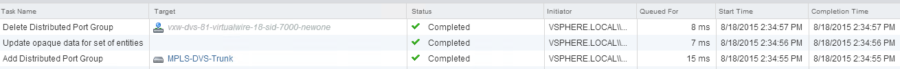

    Hi,
    I recently attempted to migrate my VXLAN transport zone to a new distributed virtual switch. Everything from the NSX Installation page looks good. The Controllers are all green, the Host Preparation tab looks (mostly) good (more on that in a second), and the VXLAN Transport and Transport Zones sections all look good as well.
    The problem is that when I go to create a new Logical Switch, I get a vague response from the GUI after the task hits 0% in the recent tasks pane: "The last operation failed for the entity with the following error message. Internal server error has occurred."
    The NSX Manager log file is much more detailed. It seems to me that there is something that NSX is looking for that is not registered, or something that is registered that NSX is not expecting. Any idea how I can resolve this? The only thing I'm suspecting is that perhaps the empty vSphere cluster that has no hosts configured for VXLAN (config status under VXLAN Transport is "Not Configured"), but I did not make that cluster part of the Transport Zone.
    Here's the log file that contains the errors generated when I attempted to create a Logical Switch.
    I HAVE rebooted the NSX Manager, but it didn't help.

  • 2.  RE: Cannot Create a Logical Switch
    Broadcom Employee
    Posted Aug 17, 2015 09:17 PM
    Do you have any existing logical switches configured in this environment?
    Do you have 3 controllers deployed?  Could you post the results for these commands on all 3 controllers?
    show control-cluster connections
    show control-cluster status
  • 3.  RE: Cannot Create a Logical Switch
    Posted Aug 18, 2015 01:56 PM
    No logical switches in the environment at all right now. I did deploy one logical switch initially when using the old DVS, but I deleted it prior to moving to the new DVS.
    Yes, I do have three controllers deployed. Here's the output you requested from all three.
    Controller 1
    htb-1n-eng-dhcp10 # show control-cluster connections
    role                port            listening open conns
    api_provider        api/443        Y        1
    persistence_server  server/2878    -        0
                        client/2888    Y        0
                        election/3888  Y        0
    switch_manager      ovsmgmt/6632    Y        0
                        openflow/6633  Y        0
    system              cluster/7777    Y        0
    htb-1n-eng-dhcp10 # show control-cluster status
    Type                Status                                      Since
    Join status:        Join complete                                08/14 17:07:10
    Majority status:    Connected to cluster majority                08/16 09:09:33
    Restart status:    This controller can be safely restarted      08/16 09:08:13
    Cluster ID:        90509f7a-a441-4930-9c11-ef2b54ea27fd
    Node UUID:          90509f7a-a441-4930-9c11-ef2b54ea27fd
    Role                Configured status  Active status
    api_provider        enabled            activated
    persistence_server  enabled            activated
    switch_manager      enabled            activated
    logical_manager    enabled            activated
    directory_server    enabled            activated
    Controller 2
    api_provider        api/443        Y        2
    persistence_server  server/2878    Y        2
                        client/2888    Y        2
                        election/3888  Y        0
                        openflow/6633  Y        0
    system              cluster/7777    Y        1
    Type                Status                                      Since
    Join status:        Join complete                                08/14 20:19:05
    Majority status:    Connected to cluster majority                08/16 09:09:34
    Restart status:    This controller can be safely restarted      08/16 09:08:34
    Node UUID:          04d83afa-0669-4c8d-a40b-8e6dc9c7ea32
    Controller 3
                        client/2888     Y         1
                        election/3888   Y         0
                        openflow/6633   Y         0
    Type                Status                                       Since
    Join status:        Join complete                                08/14 20:27:23
    Majority status:    Connected to cluster majority                08/16 09:08:13
