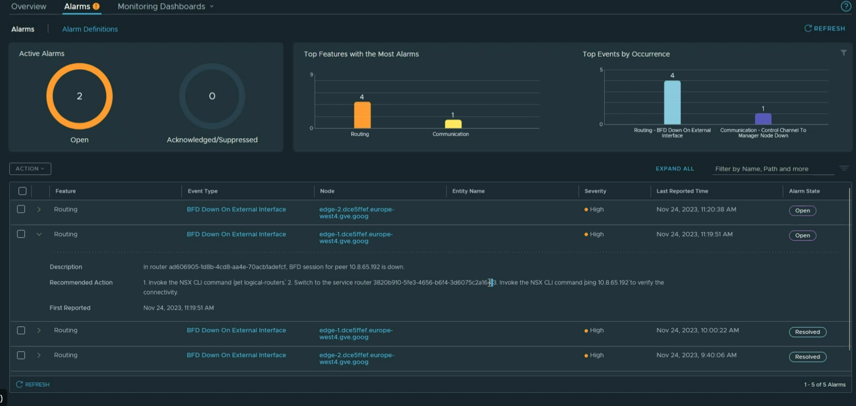

    Hi team,
    This is an GCVE environment in which we are getting BFD alerts in NSX manager UI. Though, All the services and VMs are up and running fine.
    I have checked under T0 gateways for static routes BFD peers but it is not configured. Though I tried to login to Edge nodes and getting access denied. Looks like edge nodes are managed by Google.
    Do I need to check Verify the Tier-0 Logical Router and TOR Connection? Or else the connectivity between  Cloud Router and my on-premises router.
    Regards
    PK
