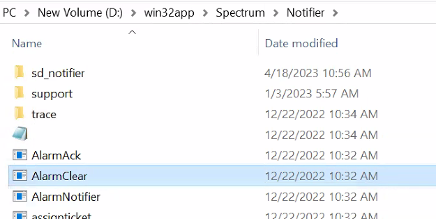

That would be correct. AlarmClear on SetScript. The SetScript is called whenever the alarm reaches the configured AlarmNotifier instance.

@Silvio Okamoto
Should I add below command having AlarmClear.exe at the end of the Set Script. Is my understanding correct?
d:/win32app/Spectrum/Notifier/AlarmClear.exe -a $GLOBAL_ALARM_ID -l $LANDSCAPE

Hi Priyesh,
You can launch the AlarmClear through one of the AlarmNotifier scripts: SetScript, ClearScript, or UpdateScript
