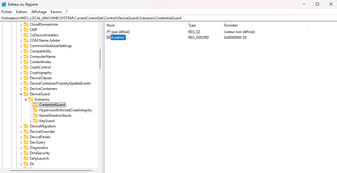

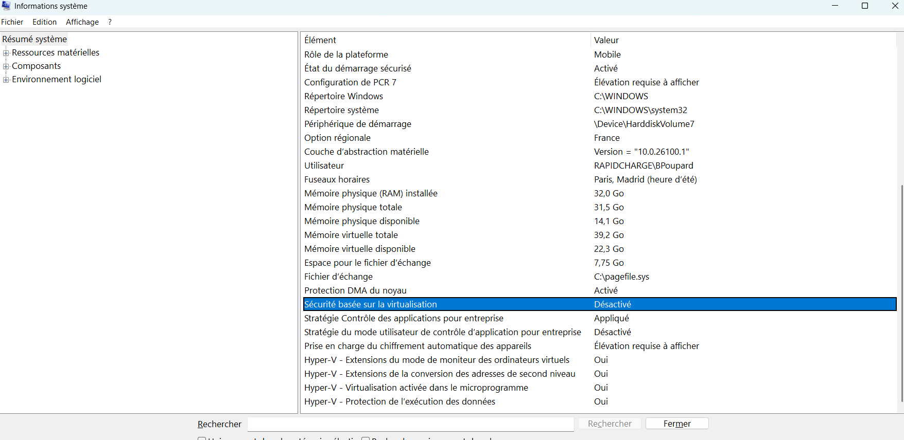

Hello,
I had the same problem and I solved it.
You need to disable the VBS on the host :
Follow this topic :
https://community.broadcom.com/vmware-cloud-foundation/discussion/windows-11-24h2-hsot-how-to-disable-virtual-based-security
Don't forget to disable also this register :
Best regards
Benjamin
