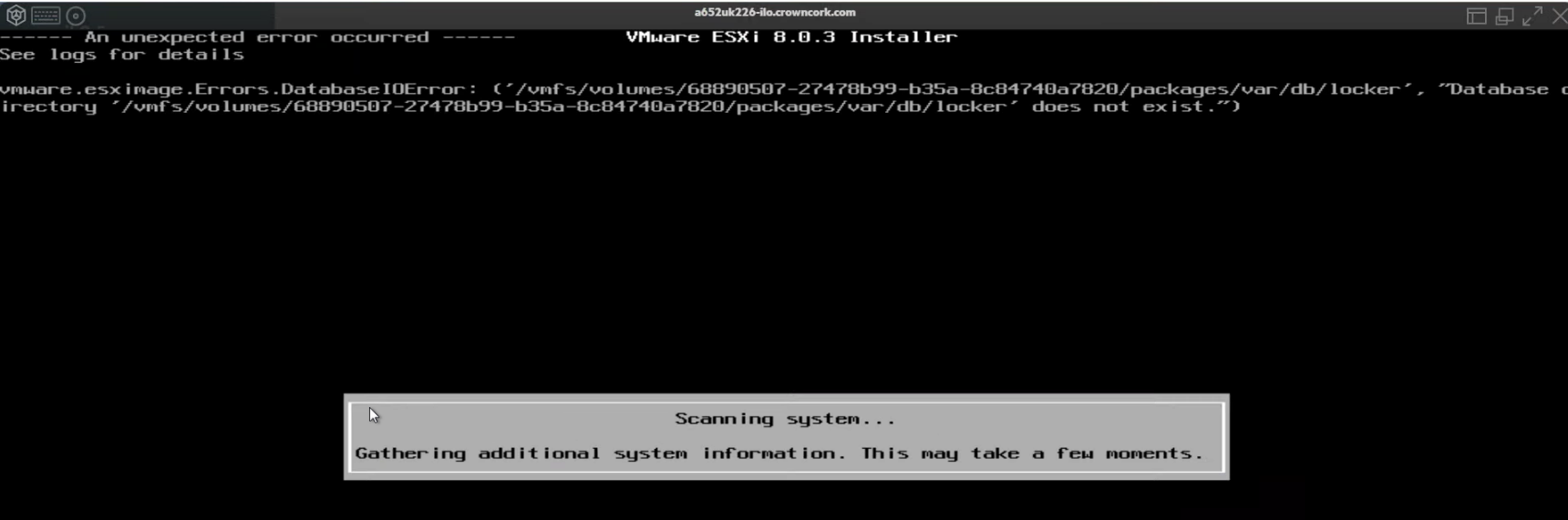

I am encountering an error while upgrading an ESXi host from VMware ESXi 7.0.3 (Build 24585291) to VMware ESXi 8.0.3 (Build 24859861).
Out of the three hosts in the cluster, two hosts were upgraded successfully using the custom image. However, one host is failing with the below error during the upgrade.
I have already logged a case with Broadcom, and they shared a reference link for troubleshooting, but I am still encountering the same issue.
Could someone please help with the steps to resolve this issue and proceed with the upgrade?
Note: This cluster is running on vSAN. Please ensure that any suggested solution does not impact the existing vSAN configuration.
Vmware.esximage.Errors.Database IOError: (‘/vmfs/volumes/688590507-27xxx-baxx-8cxxx/package/var/db/locker’, Database directory ‘(‘/vmfs/volumes/688590507-27xxx-baxx-8cxxx/package/var/db/locker’ does not exists.”)
Error:
Vmware.esximage.Errors.Database IOError: (‘/vmfs/volumes/688590507-27xxx-baxx-8cxxx/package/var/db/locker’, Database directory ‘/vmfs/volumes/688590507-27xxx-baxx-8cxxx/package/var/db/locker’ does not exist.)
