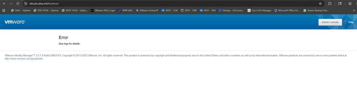

I recently upgraded my vIDM to CSP-97577 on version 3.3.7. After a ton of fixing issues with the patch, I've got it to a point where all services are running and all status reports in the UI console are green. Domain connectivity is green. Syncing to the domain works fine, no issues. However, the one thing still not working is my domain login page. When I select the domain for login it brings me to the page in the attached screenshot stating 'Error See logs for details'. The address bar contains https://<FQDN_of_IDM>/hc/error/
vIDM Domain Login Error
I've tried restoring various versions of the config-state.json file located in /usr/local/horizon/conf/states/<TENANT_NAME>/<WORKER_ID> but to no avail. If everything is reporting green and domain connectivity is working correctly, why can I not get to my domain login page?

I have resolved my issue. The issue was indeed the config-state.json file located in /usr/local/horizon/conf/states/<TENANT_NAME>/<WORKER_ID>  I had a working VM snapshot of the vIDM appliance prior to the CSP-97577 patch upgrade. I reverted the snapshot and obtained the config-state.json file from the working appliance prior to the upgrade. I then reverted the snapshot back to my upgraded vIDM appliance mentioned in the OP. I replaced the config-state.json file on the upgraded vIDM with the .json file from prior to the upgrade, BUT IT STILL DIDN'T WORK. So I did a stare and compare of the two .json files and determined the section of code for the idp (identity provider) on the upgraded .json was missing the information from the working .json. I copied and pasted ONLY the section of code under the idp section from the working .json to the upgraded .json and I am now once again able to access the domain login page and login. It looks like the upgraded .json was missing certificate information (to include the cert string and private key string under the idp section as well as a few other items of code. The idp section of the working .json file that was used to replace the upgraded .json file was:
     "idp" : {
        "isConfigured" : true,
        "host" : "<FQDN_of_vIDM_Node>:443",
        "tenantId" : "<TENANT ID>",
        "id" : 53,
        "name" : "<idp name>",
        "cert" :
"<CERT STRING>",
        "key" :
"<PRIVATE STRING>"
