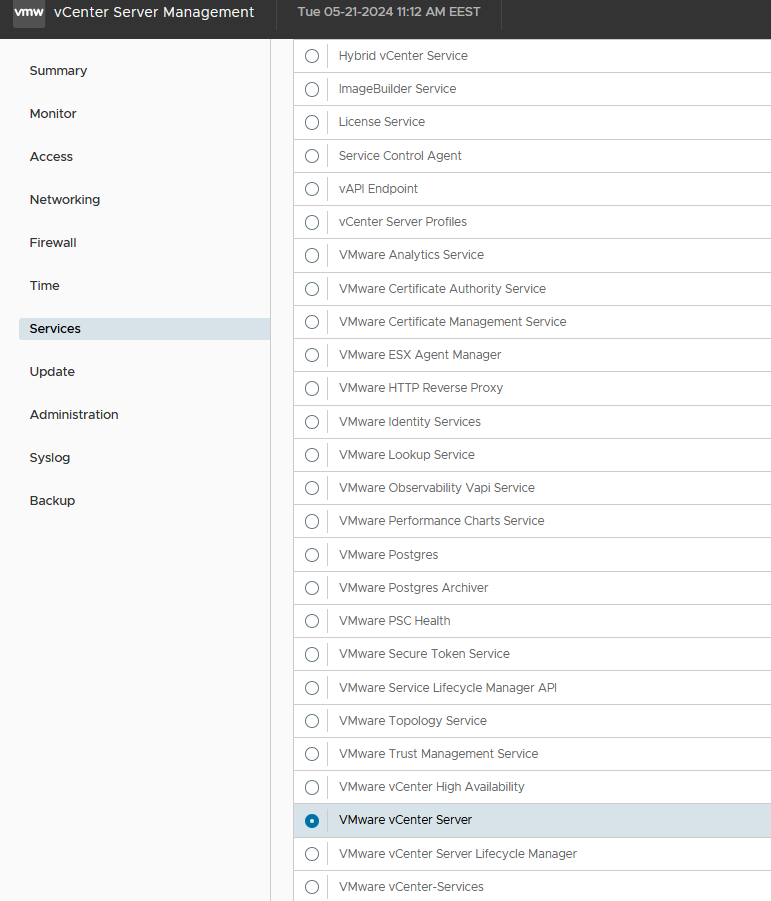

I discovered that the service is down:
if you start it, it works for a while and crashes again, usually I restart the server, then it works for almost a day, but then it crashes again.

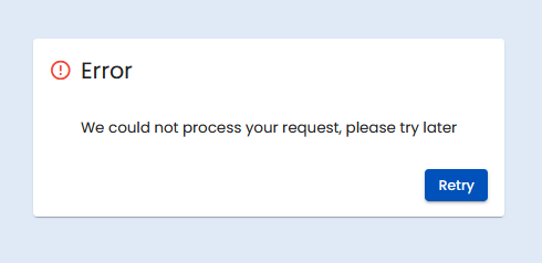

and the support is silent, I can't contact them.
Can you tell me how to solve the problem with creating a support ticket, below I add the error that is displayed when I click the "create request" button

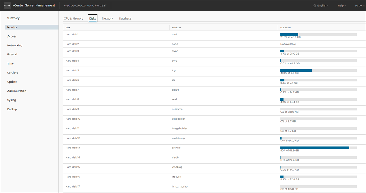

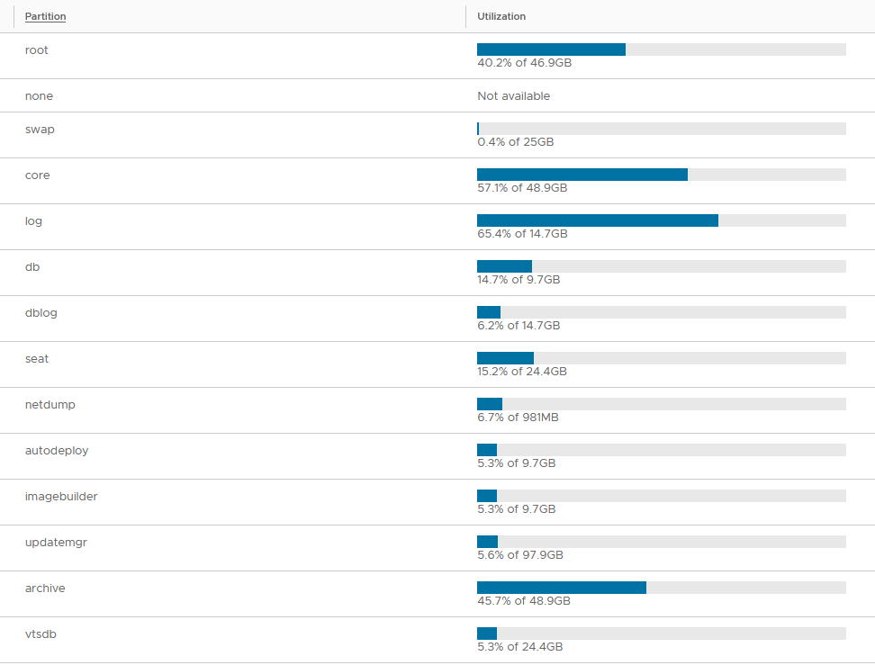

Can you check, the disk usage?
Monitor => disk tab
check if non of the drives are full of near full

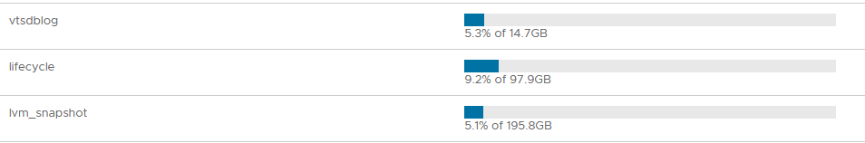

I already increased the log disk, there really wasn’t enough free space, I also added about 8 gigabytes of memory from somewhere, but to no avail (
