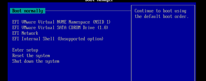

Joel Warren's profile image
Joel Warren
So I realized that the only thing I had not done was take out the trash and reboot. I did that and voila! The program seemed to install, however I got error messages which I will try to take a screenshot of it and get to you soon as I can figure out how to do that.  [Also, a third which simply said "No OS found"]
x
And a second:

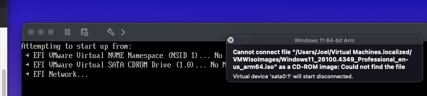

Technogeezer's profile image
External Moderator Technogeezer
Assuming you have the Windows ARM ISO configured to the virtual CD/DVD drive and that drive is set in the VMs settings to connect at startup, then it looks like you missed a step booting the media. Windows installation media displays a prompt “Press any key to boot from CD or DVD”. You must tespond to that prompt within 5 seconds or the VM will move on to try to boot from other devices (such as the network), The 2 screen shots are indicative of when this happens
For a Fusion VM, once you see that “press any key” prompt, you must do rhe following within that 5 second window:
  • click the mouse pointer in the VM’s console window or type Command-G, then
  • press any key on the keyboard
The Windows insataller should then boot.
Taking a second look at this, that message in your first screen shot is telling me the ISO file isn’t available where Fusion thinks it is. Use the Finder to look in the Virtual Machines folder in your home folder, then drill down and see if there’s a VMWisoimages folder. If so, drill into that and see if the ISO file is there (it should be a fairly large file - over 5GB)
If not, see if you moved it somewhere else and adjust your VM’s CD/DVD drive settings to point to it. If you can’t find it at all, redownload it.

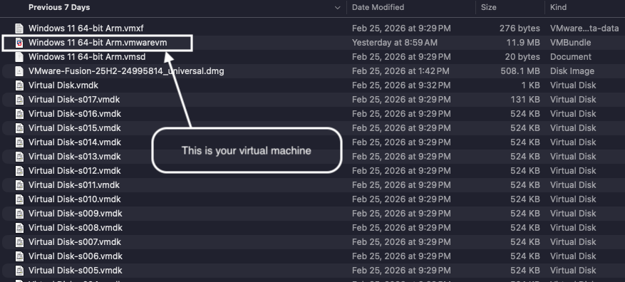

Joel Warren
I don't see any of those folders at all And if I were to redownload it, I would then ask you: from where?
Autocorrect strikes again. What got posted as “iPhone folder” should have been “home folder”.

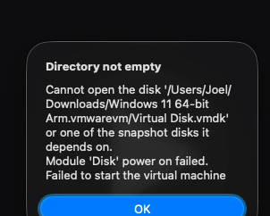

So, some updates:
Clicking on the Fusion H2 installer brings up thiw screen:  (scroll Down)
Clicking on that brings up this:
2 things:  The first screen is what I used to get whn I suspended the older Fusion, leading m to think that if I could locate the missing file and move it to where Fusion can see it, it might work.
In re the earlier question as to whether to install Windows of Fusion first, when I tried to install the Windows first, I got a message that this will delete all content and settings.  Needless to say, I quit that immediately.  But I'm thinking that maybe if that's run within Fusion, it would only apply to content and settings within Fusion.
What d'ya think?
That "directory not empty" message typically means that the virtual machine didn't power down cleanly (for a variety of reasons) and Fusion didn't clean up a lock file that keeps you from trying to run 2 instances of the same virtual machine at once.
Can you run the following in a Terminal window:
mkdir logfiles
cp /Users/Joel/Downloads/Windows\ 11\ 64-bit\ Arm.vmwarevm/*.log ./logfiles
ls -alR /Users/Joel/Downloads/Windows\ 11\ 64-bit\ Arm.vmwarevm > ./logfiles/ls-alrR.txt
tar cvfz logfiles.tar.gz logfiles
and then attach the file logfiles.tar.gz to a reply. By examining this information we should be able to see what the directory is causing this message and how to fix it.
Performing a full Windows installation from the ISO installation media lets you know that it will erase all existing content on the "hard drive". A newly created virtual machine has an empty virtual hard drive, so this warning is not a problem. It's only if you are attempting to use the ISO to install onto a system (real or virtual) that already has something installed on it that you should decide if the full installation is really what you want to do.
I made a typo in my last post - file names are case sensitve and I mis-typed it. I have corrected it in the post.

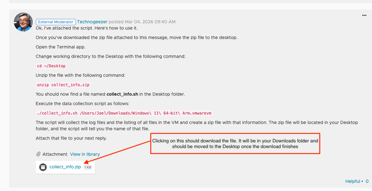

To attach a file, look below the window where you're typing a reply. You'll see blue text that says "Add Attachment". Click on that and you will get a window that says "Select files to upload". You can locate the file logfiles.tar.gz in the Finder (it will be in your home folder) and you can drag it onto that "select files to upload" window.  Or you can click on the document with a + sign on it, and a file selection window will appear - that will allow you to navigate to your home folder and find the logfiles.tar.gz file to upload.
You should be able to copy each line of the commands I've provided by highlighting each line with the mouse, right clicking, and select "Copy" (or if you like using the keyboard type Command-C). Then click back in the Terminal window and either right-click and select "Paste" or type Command-V. Then press Return to execute the command.

Ok, I've attached the script. Here's how to use it.
Once you've downloaded the zip file attached to this message, move the zip file to the desktop.
Open the Terminal app.
Change working directory to the Desktop with the following command:
cd ~/Desktop
Unzip the file with the following command:
unzip collect_info.zip
You should now find a file named collect_info.sh in the Desktop folder.
Execute the data collection script as follows:
./collect_info.sh /Users/Joel/Downloads/Windows\ 11\ 64-bit\ Arm.vmwarevm
The script will collect the log files and the listing of all files in the VM and create a zip file with that information. The zip file will be located in your Desktop folder, and the script will tell you the name of that file.
Attach that file to your next reply.
Attachment  View in library

Thanks for the upload and I think I can solve the "directory not empty" message you're getting.
First, make sure the Fusion application and GUI are shut down.
Next, find the VM in the Finder - it looks to be in your Downloads folder. (more on that in a second).
Once you've located the VM, right click on it and select "Show Package Contents". A Finder window will open showing all the files that make up your virtual machine.
You should see a folder in that window named "Virtual Disk.vmdk.lck". That's the lock file that didn't get cleaned up and is preventing you from powering on the VM.  Move that file to the Trash, close the Finder window, and empty the trash.
Before powering on the VM, one comment. The Downloads folder is not the best place to store a virtual machine. A better place is the default location - a folder named "Virtual Machines" that you will find directly under your home folder. You should be able to find it by going to the FInder's menu bar, clicking "Go" and selecting "Home".  Open a second Finder window, navigate to the Downloads folder, and drag the virtual machine from the Downloads folder to the Virtual Machines folder (that will move it rather than copy it).
Once that's done, let's tell Fusion to forget about the old virtual machine. Open Fusion, right click on the old virtual machine that's in the Virtual Machine Library window, and select Delete. Don't worry, in this case it won't do anything other than forget the original virtual machine. In other cases it will ask you if you really want to remove the virtual machine's files, or simply forget about it.
Now let's add the virtual machine back into the Virtual Machine Library. There are a couple of ways to do that, but in this case we'll select File > Scan for virtual machines... from the Fusion menu bar. You'll then  a window named "Scan for Virtual Machines", and listing directories that it should scan to find them. The default Virtual Machines folder should be in that list. If not, hit the + sign, and use the file navigation box to locate your home folder. The Virtual Machines folder should be found in that folder. Select it, click Open and the folder should now appear in the list.
Once you've verifed that the default folder location is in the "Scan for Virtual Machines" list, click the Scan button.  The virtual machine you moved should now re-appear in the Virtual Machine library.
Now power on the virtual machine -- the "directory not empty" message should not re-appear. You should then be able to start the Windows installer (remember that "press any key to boot from cd or dvd" message is on a 5 second timer....).

No Virtual Disk.vmdk.ick file, because, per your earlier suggestions I had deleted all files saying Virtual Machine or VMware, or so I thought. But found a VMware.fusion.app file in downloads, opened the package contents and under contents\library found this first screen shot.  Then I searched for VM in downloads and came up with the second screenshot.  Nothing close to what you had me looking for.  There's tons here that you could only know about by coming onto my machine like the good old VMware techs used to routinely do back in the day.  So, where do we go from here?
PS remember that, after doing the first round of deletions I was able to install the new Fusion without the "other version running" message.  Now the only issue is the inability to run because of missing file or files (earlier screenshot)

Anybody got any help for me on the latest posts?  Or at least a direction I can head in?  I'm about to throw in the towel and try Boot Camp or Parallels.
The first screen shot you posted (with title bar Library) is part of the VMware Fusion application itself. It has nothing to do with the issues you're seeing and you shouldn't do anything with therm.
The second screen shot
appears to be your Desktop folder.
The file "Windows 11 ARM 64-bit Arm.vmwarevm" is your virtual machine. (it's actually a special type of folder whose contents are hidden). Right click on the virtual machine and select "show package contents" to open a Finder window to reveal what's in it. It should contain many files, including any .lck lock folders, and .vmdk files that make up your virtual hard drive for the VM. According to the logs you posted, the folder with the .lck
I'm a bit puzzled, though, as to why there are files with a .vmdk extension in your Downloads folder. They should not be there - they should be located within the .vmwarevm folder.
I'm sorry, I meant that the second screen shot is the Downloads folder, not the Desktop folder.

It is indeed my Downloads folder.  Can't tell you why there are vdmk files, but there is no vmwarevm folder anywhere.
Upon second look, that's doesn't appear to be your Downloads folder. Note the header that's at the top of the column of file names. It says "Previous 7 days", which leads me to think that you're seeing a list of files that have been recently modified. (It would have been helpful if your screen shot included the whole Finder window including the top and side bars.) If the Finder is showing recently modified files, it may display them regardless of their location. That would explain some other files I see in this listing that wouldn't belong or be found in the Downloads folder.
That listing does have the virtual machine:
If you see that file from this screen, right click on that and select "Get Info". That will tell you where the virtual machine is stored (it should be your Downloads folder).
Take another look in your Downloads folder. If you find that file name without a .vmwarevm extension, but is still listed as a VMBundle in the "Kind" column, that is your virtual machine.  It's possible that the Finder has hidden the extension. (You can confirm that with Get Info). Then right click that and select "Show Package Contents". The lock file folder I identified should be there.
