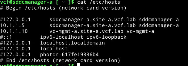

I am having issues getting past the "Generate and Install VMCA Certificate on SDDC Manager" step.  I've tried adding the sddc manager and vCenter IPs to /etc/hosts as well as commenting out the loopback Ips in /etc/hosts.  I've tried deploying to standalone host and to vCenter, to vDS and vSS, trying with standard subnets and custom subnets...nothing works.  Nslookup on sddc manager is working properly with name and IP.  I can see in the log that name resolution is working properly.  Pasting some output from vcf-commonsvcs.log.   Any suggestions?

@Brain Taylor,
We have come across this, I could share the resolution but before that I want to make sure that the symptoms are same. Could you cat /etc/hosts file and share the output here pls?
