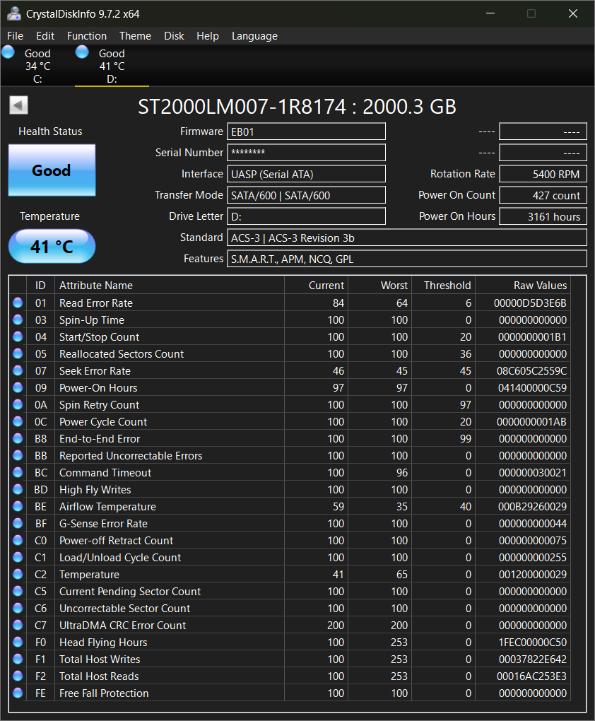

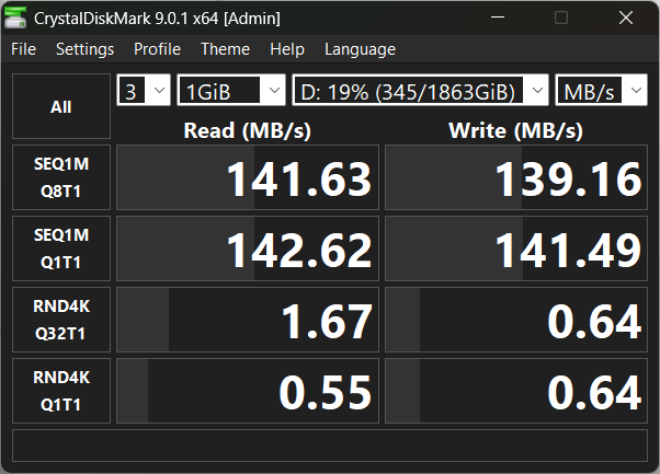

    I used cystaldiskinfo + crystaldiskmark to get information
    The cable is the cable the drive came with (usb-c to micro-usb super speed)
    It is a spinning hard disk, so that might be the problem.

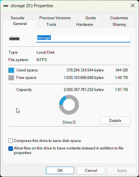

    Here's what windows shows under properties.
    Attempting to run chkdsk, and will defragment, but if anyone wants more info, please let me know.

    The problem is the spinning disk. Those measurements are misleading - it is much slower in VMware compared to what you see. Just move to SSD technology.
    The cable is probably OK if it came with the disk. Based on your description, it seems that the PC connection is also OK.
    As for fragmentation - it is a hassle. I would defrag it in Windows, but then you need to defrag in VMware - there is a menu for that. If the disk is fragmented, the performance will suffer or greatly suffer. You need to keep on defragmenting - the technology is inferior compared to SSD.

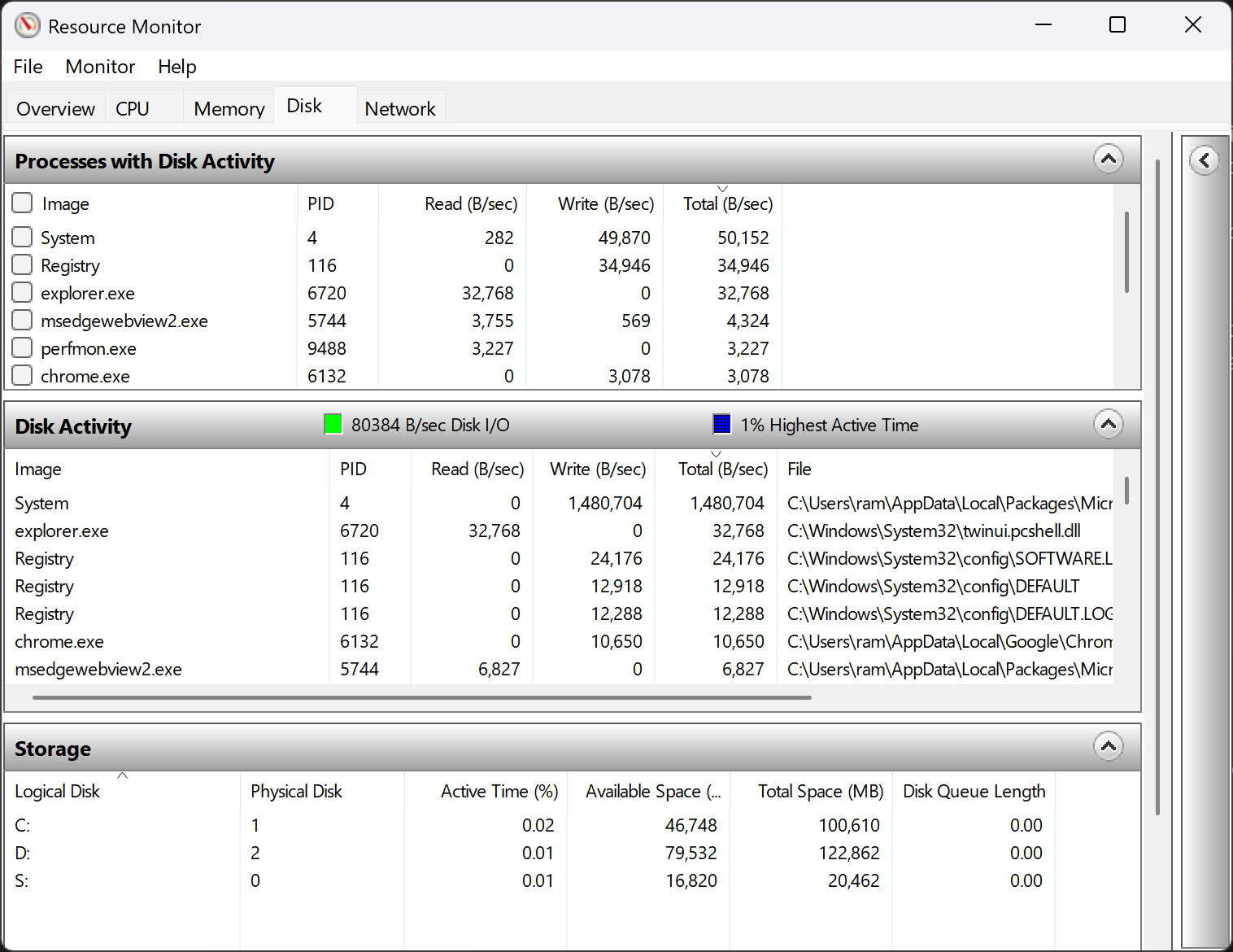

    Repeating that VM creation process with Resource Monitor open could be interesting.  It'd help zero-in on what's being accessed and which process is responsible.
