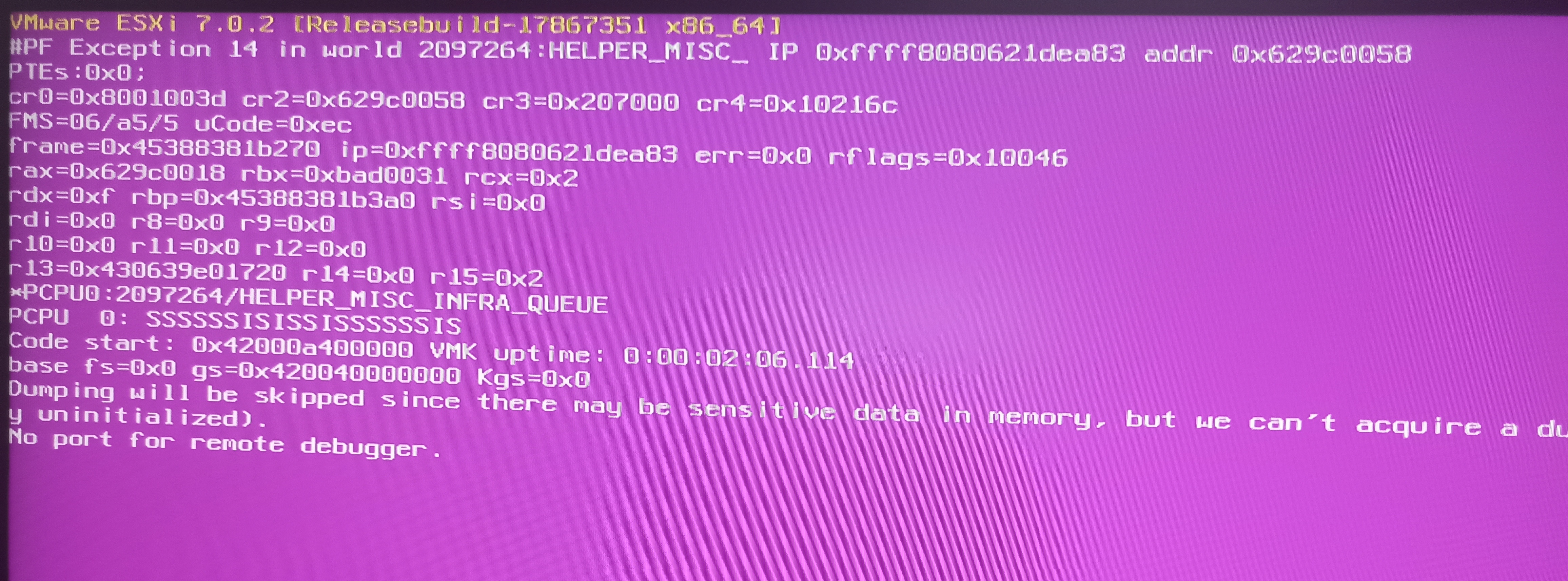

    Hi all,
    I have been tinkering around with a Dell 7090 and got ESXi installed; however, whenever a request is made to shutdown the host, it purple screens on me with a "PF Exception 14" referencing HELPER_MISC_ and later on referencing "HELPER_MISC_INFRA_QUEUE" for "PCPU0". Does anyone know what "HELPER_MISC_INFRA_QUEUE" does? This only happens during shutdown and does not happen during restart. I could not find any similar issues referenced on the Internet. I did try switching some hardware around to see if it helps, but it did not (did not try swapping CPUs, unfortunately I don't have an extra of those lying around). Any help would be much appreciated.

    Same problem with Dell OptiPlex 7090. Use ESXi 7.0.2 (17867351) and community network-driver for I219-LM driver. Others all keep default. All goes well except when host powering off, PSOD happens. Restart process is ok.

    It looked like the error we are having (except for reboot), but for ESXi 6.7 citing VMD drives connected through PCIe switch (could also be me being completely wrong). I did testing v2.7.0.1157 of the vmd, but it did not help for my system. Maybe better luck for you or anyone else having a similar problem.

    I encountered this with both 7.0u3u and 8.0.1on a Dell Optiplex 7090. Updating to the latest BIOS fixed it.

    i have a 7090 SFF and solved this by updating to the latest BIOS
