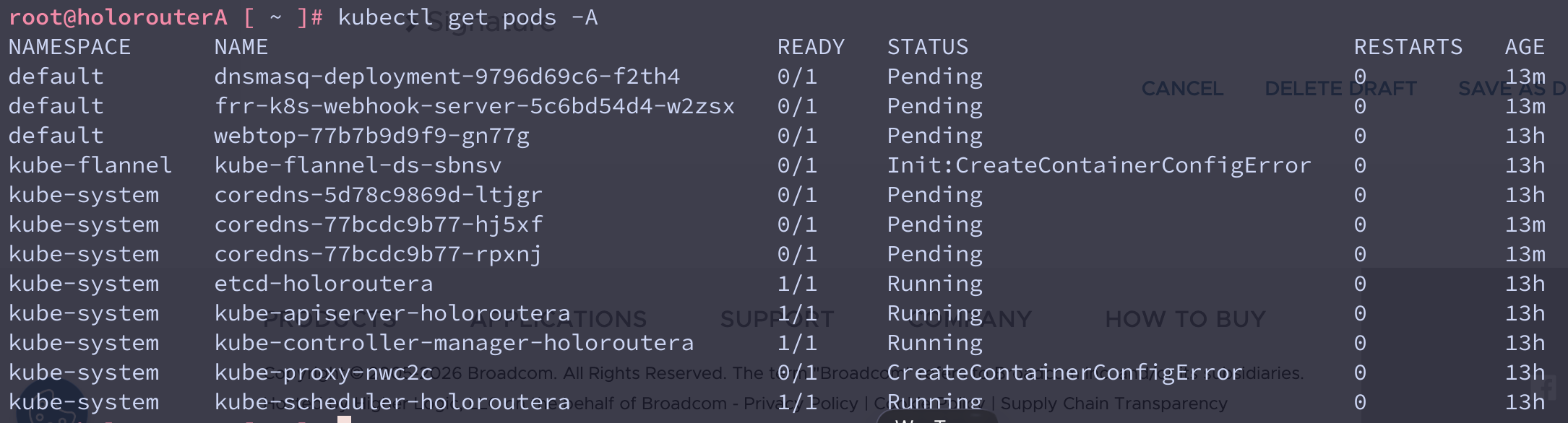

Has anybody ever got to the root of this? I'm currently running into it as well. Trying to deploy 9.0.1.0 to a v8 environment. I've rebuilt the holorouter I think fixing some of my networking setup; didn't realize there should be 4 PGs total in play here (unless I'm wrong):

Trying to install holorouter and am stuck Waiting for FRR service.
Have run the install twice... the first time the Waiting for FRR service looped for over 5 hours before killing the process. Ran a second time and the log file looks like:

$error | out-file error.txt results with:
New-Item: The file '/holodeck-runtime/output/network_manager_config_site_a.yaml' already exists.
Get-Item: Cannot find path '/holodeck-runtime/output/output.txt' because it does not exist.
