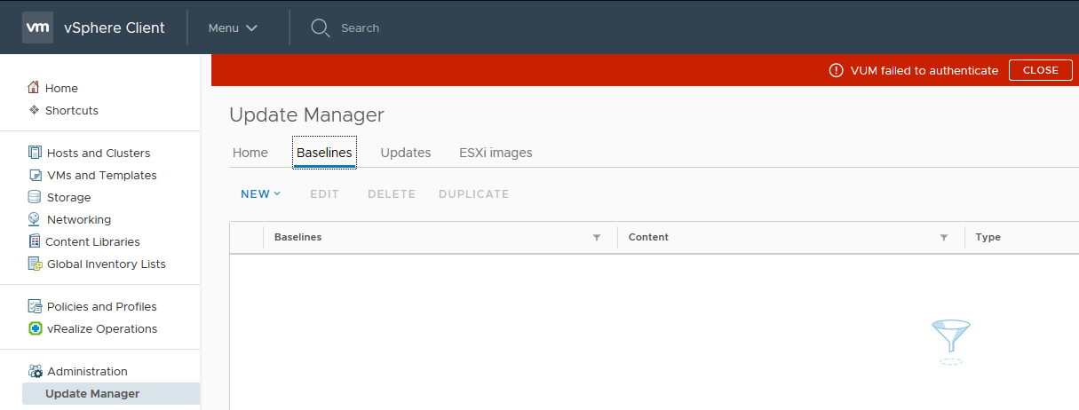

    Hi,
    I'm facing this error everytime on my vCenter 6.7:
    I tried restarting the service, but everytime I logon again on vCenter it continues to show up.
    Any advice?

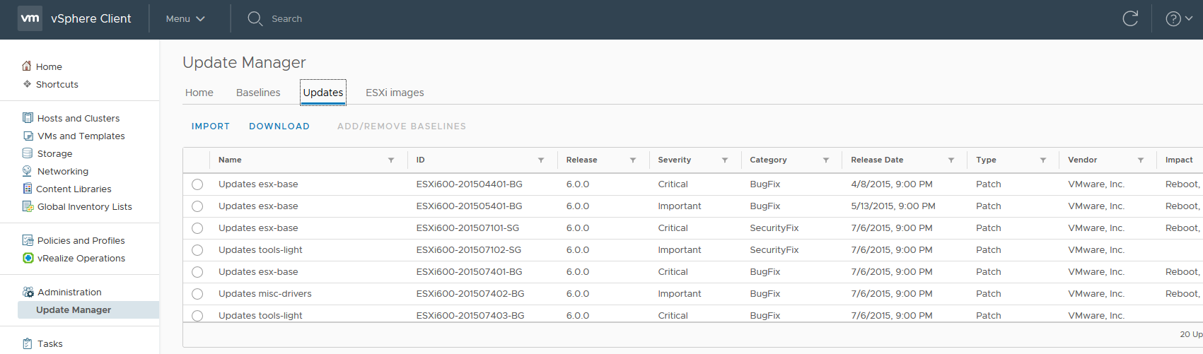

    Yes, the VUM works normally if I just restart the service.
    It is vCSA.
    This is the same vCenter after restarting the service:

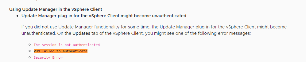

    This is Known Issues
    Check if the following VMware KB article helps: VMware Knowledge Base
    VMware vSphere Update Manager 6.7 Release Notes
