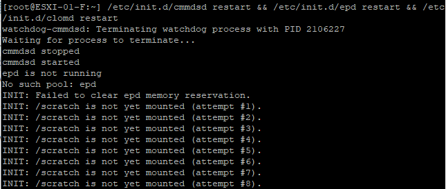

    I just enabled vSAN, and its currently failing hard.
    EPD won't start on my ESXI-01 server (see picture below)
    If I try to start the service manually via SSH, i get below error:
    Any tips on how to fix this? There is extremely little to be found when using google :smileysad:
    Thanks in advance

    But it appears that you already found this and it looks like restarting the service is not working for the same reason that it did not start automatically in the first places (e.g. /scratch partition which is required for this to start is not available).
    I would advise investigating whether /scratch is full (or out of inodes) and/or there is some other reason it cannot be written to.

    Start by SSHing to the host and check does it even exist e.g.:
    # cd /scratch
    This should then show where scratch is pointed by the directory path changing e.g. if it is pointed to /tmp then it will look like:
    [root@esx-01:/tmp/scratch]
    If it is stored on a persistent or vfat partition then check if any of these are out of space (e.g. Use% is 100%):
    # df -h
    If it is stored in a Ramdisk (e.g. like /tmp) then check the available space on these:
    # vdf -h
    So basically it is case of first validating /scratch exists (corner-case being those without this like diskless Auto-Deploy hosts which are not supported for use with vSAN) and then validating that it has free space and inodes - if it doesn't then figure out what is consuming the space (e.g. something logging to the same parent directory) and free up space and redirect whatever was filling it to somewhere else more appropriate where it won't cause problems.

    One thing that I noticed is that even the scratch partition was not full ( location was in tmp\...) there was not enough space in there because the esxi was installed on an Sd card. I needed to provide a partition big enough and change the scratch location. After restart everything worked fine. I hope this will help you.

    Yes.I also faced the same kind of issue.
    I sorted it out in the same way for VSAN.
    with command line
    vim-cmd hostsvc/advopt/update ScratchConfig.ConfiguredScratchLocation string /vmfs/volumes/f9d66946-bdd7efac/scratchlogs/ESXi-01
    f9d66946-bdd7efac-->This is my external NFS server id,created a folder called "Scratchlog/ESXi-01"
    After configuring/reboot of ESXi,that error message was gone in the skyline health(VSAN-Monitor)
