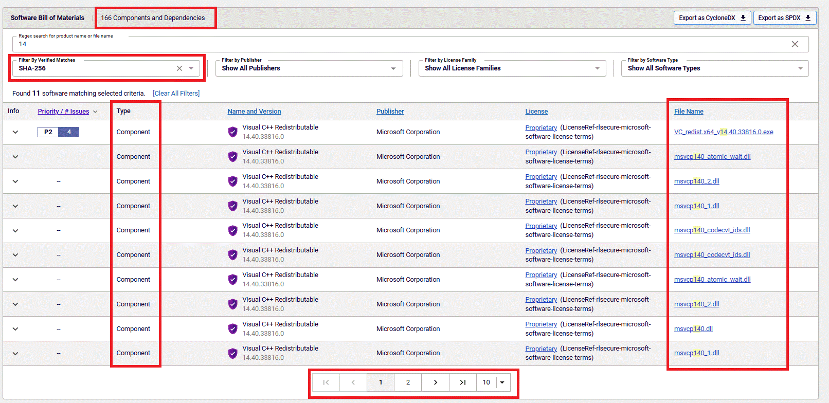

  • 5.  RE: VMware-workstation-full-17.6.4-24832109.exe Scan issues
    Posted 26 days ago
    Hi Allan,
    Thank you for your prompt follow-up.
    The requested information should be in the provided ReversingLabs report link already provided below.
    I've also included screenshots and supporting information.
    If possible, please have Broadcom to contact me directly by phone or chat. I'll then loop in our Cybersecurity SME to review the report and answer questions

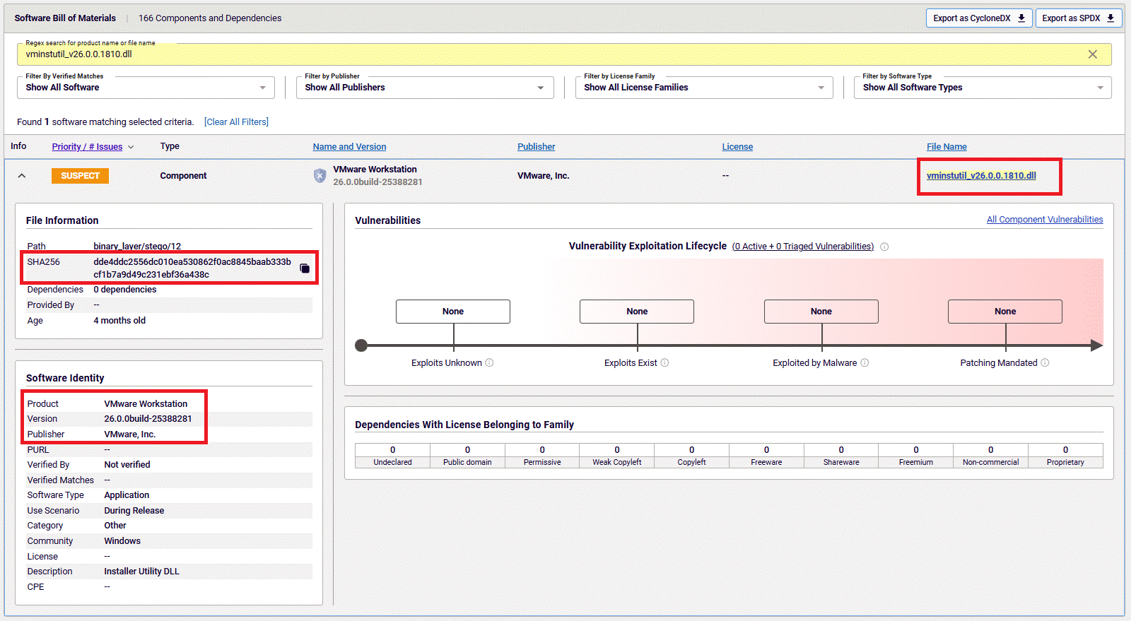

    SHA256: The two binaries detected and failed
    1.1 Path:binary_layer/stego/12
    1.1 SHA256: dde4ddc2556dc010ea530862f0ac8845baab333bcf1b7a9d49c231ebf36a438c
    1.2 Path: binary_layer/stego/14
    1.2 SHA256: d530f434163428dc8ff46c30149f1350e6bc517ce91c8b27f23929a133360246
    2.                  ReversingLabsReport link: https://ca.secure.software/cityofcalgary/shareable-reports/hDcJ3QuXy6H-xgKX7KeW36bRvSlDFmif_IX9A9GfkKfdfXyowk-5JwwQB5HOfM_rg80NVn7hvfv_qQYOgm1c8udYXfV-E8P5MgP0hwpDWhi-pbsRVyn8YdllhmBwmk6jDJjmrxiYk5HMkDChflyiOIylcOCPAmAgHRY8xeRZy9w?fp=a0dbc0ec-8ec6-4d68-8402-bf3d5fe1332f
    Password: Y6tJSnjBI_2iSLEVi0QCEw
    1.  VMware Workstation version/build: 26.0.0build-25388281
    2. component-level findings if available: There are 166 components and dependencies - see in the ReversingLab report as shown in the screenshot below
