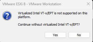

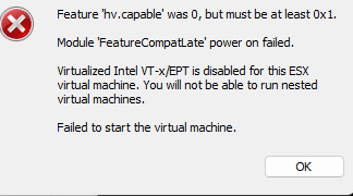

    I am having an issue when trying to run any Virtual Machine on my Windows 11 host machine using VMware Workstation Pro 25H2 in which I cannot understand what is causing this issue.
    Any Virtual Machine that I try and run, I'm always getting pixelation and or a black screen causing me to force restart the VM. This happens even with 3D Acceleration disabled.
    VMware is also preventing me from enabling the 'Intel VT-x/EPT' even though my system is fully capable of running virtual machines and have already enabled the setting on my system BIOS, the VM refuses to start with it enabled and I have already disabled Hyper-V on my host machine.
    I have already tried the following:
    Disabling side channel mitigations.
    Disabling 3D Acceleration.
    Installing Guest Additions inside the VM, downgrading to the previous version made no difference.
    Increasing resources to the VM.
    Downgrading VMware workstation to an older version.
    Updating System BIOS to the latest.
    Using the 'bcdedit /set hypervisorlaunchtype off' command via Power Shell.
    -System Specs-
    Windows 11 Pro 25H2
    VMware version: 25.0.1.25219725
    OS Build: 26200.9168
    MSI Z790-P
    Intel 12700K
    32GB Installed RAM
    GeForce GTX 1660Ti Super
    Any suggestions are appreciated.
