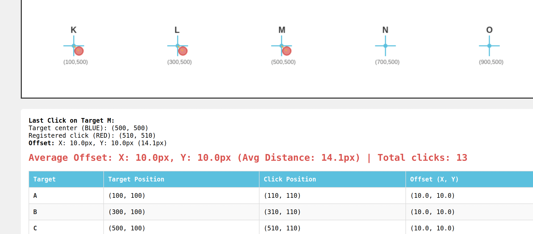

  • 9.  RE: VMWare Fusion 25H2 Regression - Linux mouse cursor offset, no problem with Fusion 13.6.4
    Posted Nov 29, 2025 03:25 PM
    Hi @Neethu Kumar Swamy
    Can you provide an update?  This bug makes it extremely frustrating to write code in VS Code inside the guest VM.
    Host: Macbook Pro / Mac OS Sequoia 15.7.2
    Software: VMWare Fusion Professional 25H2 (24995814)
    Guest: Ubuntu 24.04.3 LTS (Wayland)
    I tested in Firefox on a 14" MBP on Ubuntu at 3024x1890 res at 200% scale, with this tool, and it shows about a 10pixel offset, down and to the right:
