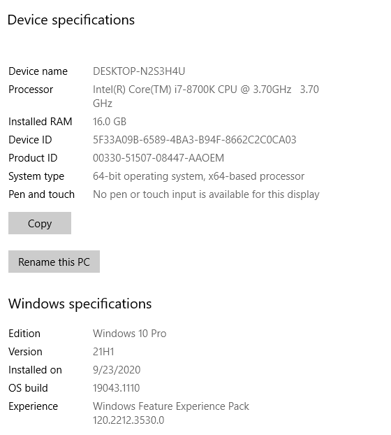

    Host OS - Windows 10 Pro
    VMware Version - Workstation 16 Pro
    Virtual Machine Operating Systems - Windows 10 Enterprise and Ubuntu 18

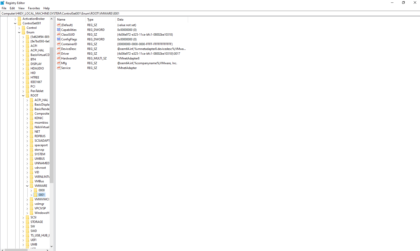

    Previously, a person called "continuum" suggested checking the registry at HKEY_LOCAL_MACHINE\SYSTEM\ControlSet001\Enum\ROOT\VMWARE\0000
    HKEY_LOCAL_MACHINE\SYSTEM\ControlSet001\Enum\ROOT\VMWARE\0001
    to see if the install was complete, so here are screenshots of that:

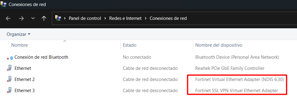

    I have two virtual adapters that get installed along with FortiClient VPN. I currently use FortiVPN to connect remotely to my company's network using authentication and an assigned IP address. Now, I am facing the same problem with VMware as the original poster. My main question is: if I perform a network reset, would it affect the FortiClient VPN adapters?
