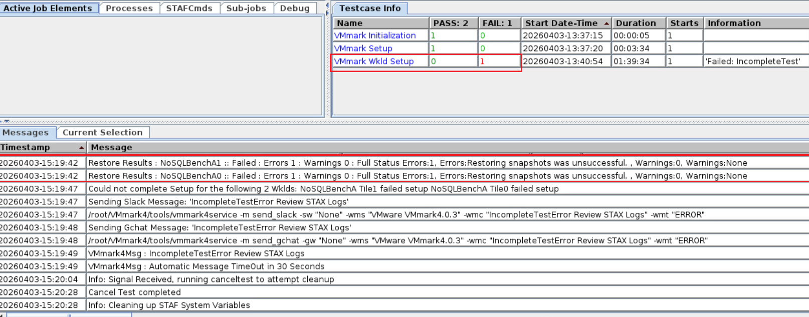

    we are trying to run VMmark4.0.3 benchmark @ 4 tiles. when initiated the benchmark, it fails in workload setup with the following error. we tried re-provisioning the VMmark4 tiles, still the issue persists. attached the log file for further analysis. Please let us know if any one of you experienced this issue and resolved from your end, how this issue can be resolved? Appreciate your input on this. Thanks.
    Since my log file upload is failing, this is the log file content:
    Fri Apr  3 03:05:39 PM PDT 2026 : Starting NoSQLBench restore v. 04152025, writing to /NoSQLBenchA0_restore.txt
    Fri Apr  3 03:05:39 PM PDT 2026 : cassandra is running on NoSQLBenchA.
    Fri Apr  3 03:05:40 PM PDT 2026 : Node NoSQLBenchA reports all nodes up and normal.
    Fri Apr  3 03:05:40 PM PDT 2026 : cassandra is running on NoSQLBenchB.
    Fri Apr  3 03:05:41 PM PDT 2026 : Node NoSQLBenchB reports all nodes up and normal.
    Fri Apr  3 03:05:42 PM PDT 2026 : cassandra is running on NoSQLBenchC.
    Fri Apr  3 03:05:43 PM PDT 2026 : Node NoSQLBenchC reports all nodes up and normal.
    Fri Apr  3 03:05:44 PM PDT 2026 : Restoring snapshots on all nodes.
    Fri Apr  3 03:19:41 PM PDT 2026 : Restoring snapshots was unsuccessful:

    Hi Sivakumar,
    We have not seen this particular error before. Some questions:
    • From the screenshot, it appears the restore failed on at least the first two tiles (0 and 1). You say you're trying to run 4 tiles. Have you successfully run 1, 2, and/or 3 tiles prior to this?
    • NoSQLBench is disk I/O intensive. Can you send me the details of your storage subsystem (for example: # of disks, vSAN vs. SAN, RAID level, etc.)?

  • 4.  RE: VMmark4 benchmark fails in NoSQLBench Workload setup
    Broadcom Employee
    Posted Apr 06, 2026 05:18 PM
    1) It's very strange that changing to CPUs with more cores would cause problems even at 1 tile when you were able to run 1-2 tiles with the lower-core count CPUs.
    2) Okay, 3 NVMe disks may become a bottleneck at higher tile counts, but I'm glad to hear you have been have to run 2. What were the scores for each?

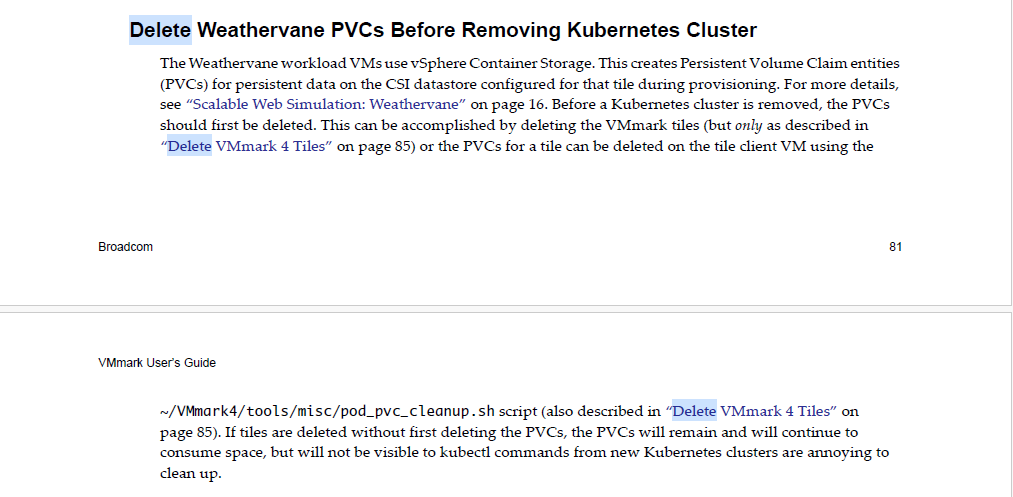

    on Delete Tiles, we followed the pprocedure described in user guide. what we followed was
    1) delete the PVCs using the pod_pvc_cleanup.sh
    2) followed by delete tiles using "vmmark4service --mode delete_all_vmmark4"
    this is exactly we followed. let us know if this is right procedure.
    2) on the file upload, yes will work with my team here and update you in case if we can enable access to you to download files from our sharepoint
  • 6.  RE: VMmark4 benchmark fails in NoSQLBench Workload setup
    Broadcom Employee
    Posted Apr 06, 2026 06:02 PM
    Yes that is the right procedure, so I do not know why it worked the first time and not now.
