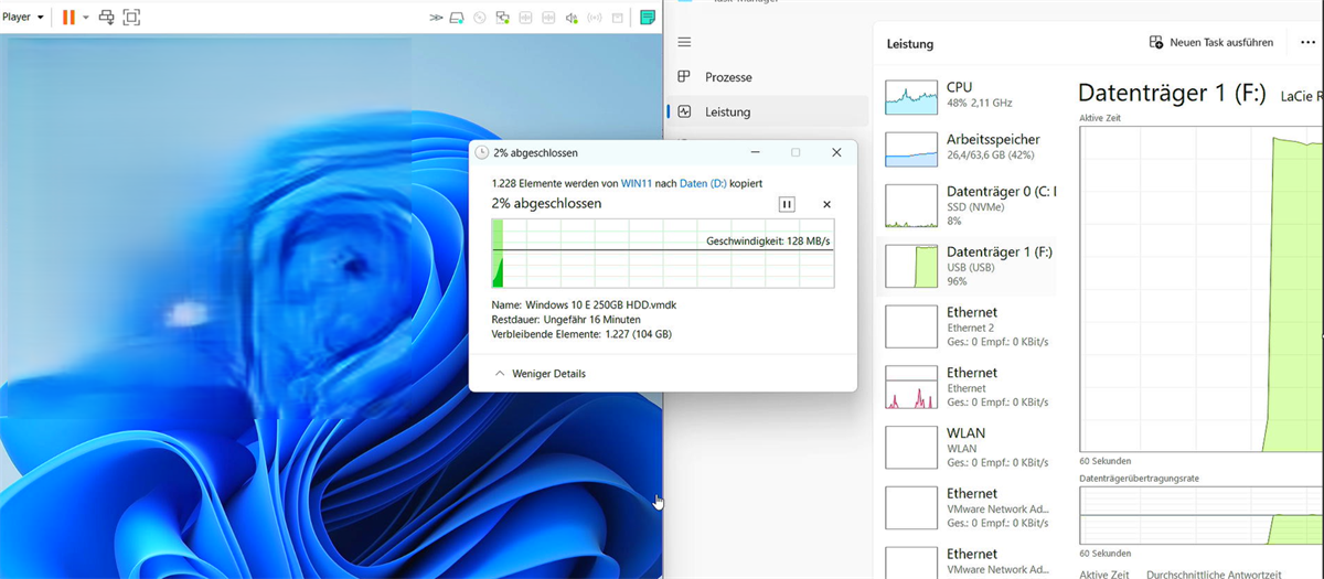

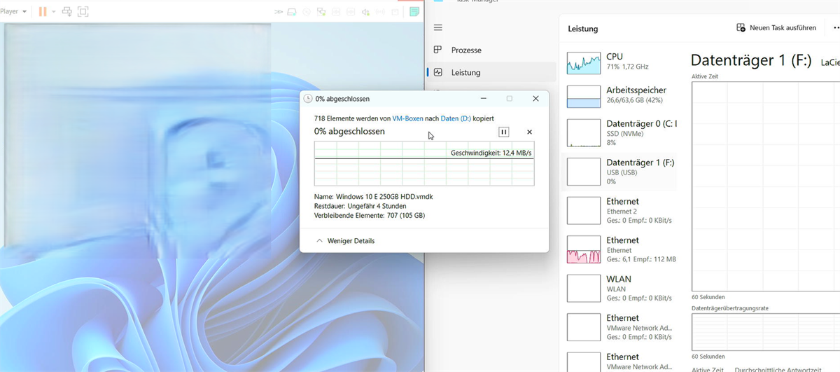

    Hello Richard,
    there is MS Defender on the Client machine. But I don't think this is because of the host PCs I/Os. I test it with a USB drive and copy on the host PC something to the local disk. Everything works fine. When I do the same thing from the SMB Network share and copy a large file to the local host disc, the opened VM freezes.
    SMB Share copy:
    copy from smb to local host disc
    USB disc copy:
    copy from usb to local host disc
