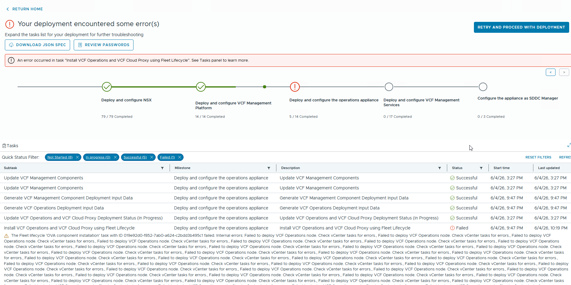

    I'm deploying a greenfield VCF 9.1 and it's gone pretty smooth up until this point.
    Deploy and configure the operations appliance - fails at 5/17 with a wall of text, repeating itself over and over.
    The Fleet lifecycle 'OVA component installation' task with ID 019e92d0-f852-7ab0-a624-c2bdd3b495c1 failed. Internal errors: Failed to deploy VCF Operations node. Check vCenter tasks for errors
    I've looked through the vCenter and all i can see is that it starts deploying the OVF and it cancels the deployment exactly 8 seconds later - it repeats this over and over again until the SDDC installer throws the errors.
    I've checked all DNS lookups, regular and reverse.
    I've checked NTP - everything is within 0,5 seconds of eachother.
    Anyone got any bets on what it could be? I've tried searching through the logs on the SDDC manager / VCF installer but nothing really shows - the reference token just leads me to "check vcenter" and the events + tasks shows deployment + cancellation.
    The VPXD log also just shows that the "user" deploys and the "user" cancels...
