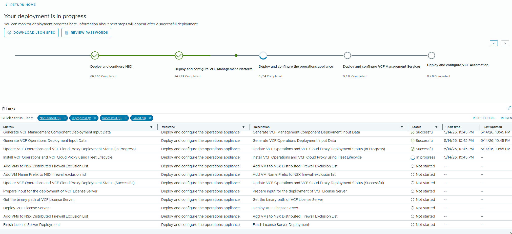

    I restarted to deploy many times. It stucks.
    Install VCF Operations and VCF Cloud Proxy using Fleet Lifecycle
    Deploy and configure the operations appliance
    Failed
    5/13/26, 7:51 AM
    5/13/26, 9:20 AM
    Beginning of Expandable row content Screen reader table commands may not work for viewing expanded content, please use your screen reader's browse mode to read the content exposed by this button
     The Fleet lifecycle 'OVA component installation' task with ID 019e1f97-57d9-785e-adf4-3bade7e0d4f3 failed. Internal errors: Status polling timed out. Review the logs to check operation progress. Increase the timeout value if the operation requires more time., Status polling timed out. Review the logs to check operation progress. Increase the timeout value if the operation requires more time., Status polling timed out. Review the logs to check operation progress. Increase the timeout value if the operation requires more time., Status polling timed out. Review the logs to check operation progress. Increase the timeout value if the operation requires more time., Status polling timed out. Review the logs to check operation progress. Increase the timeout value if the operation requires more time., Status polling timed out. Review the logs to check operation progress. Increase the timeout value if the operation requires more time., Status polling timed out. Review the logs to check operation progress. Increase the timeout value if the operation requires more time., Status polling timed out. Review the logs to check operation progress. Increase the timeout value if the operation requires more time., Status polling timed out. Review the logs to check operation progress. Increase the timeout value if the operation requires more time., Status polling timed out. Review the logs to check operation progress. Increase the timeout value if the operation requires more time., Status polling timed out. Review the logs to check operation progress. Increase the timeout value if the operation requires more time., Status polling timed out. Review the logs to check operation progress. Increase the timeout value if the operation requires more time., Status polling timed out. Review the logs to check operation progress. Increase the timeout value if the operation requires more time., Status polling timed out. Review the logs to check operation progress. Increase the timeout value if the operation requires more time., Status polling timed out. Review the logs to check operation progress. Increase the timeout value if the operation requires more time. Reference Token: OUDL85

    i can complete to deploy to change NTP
