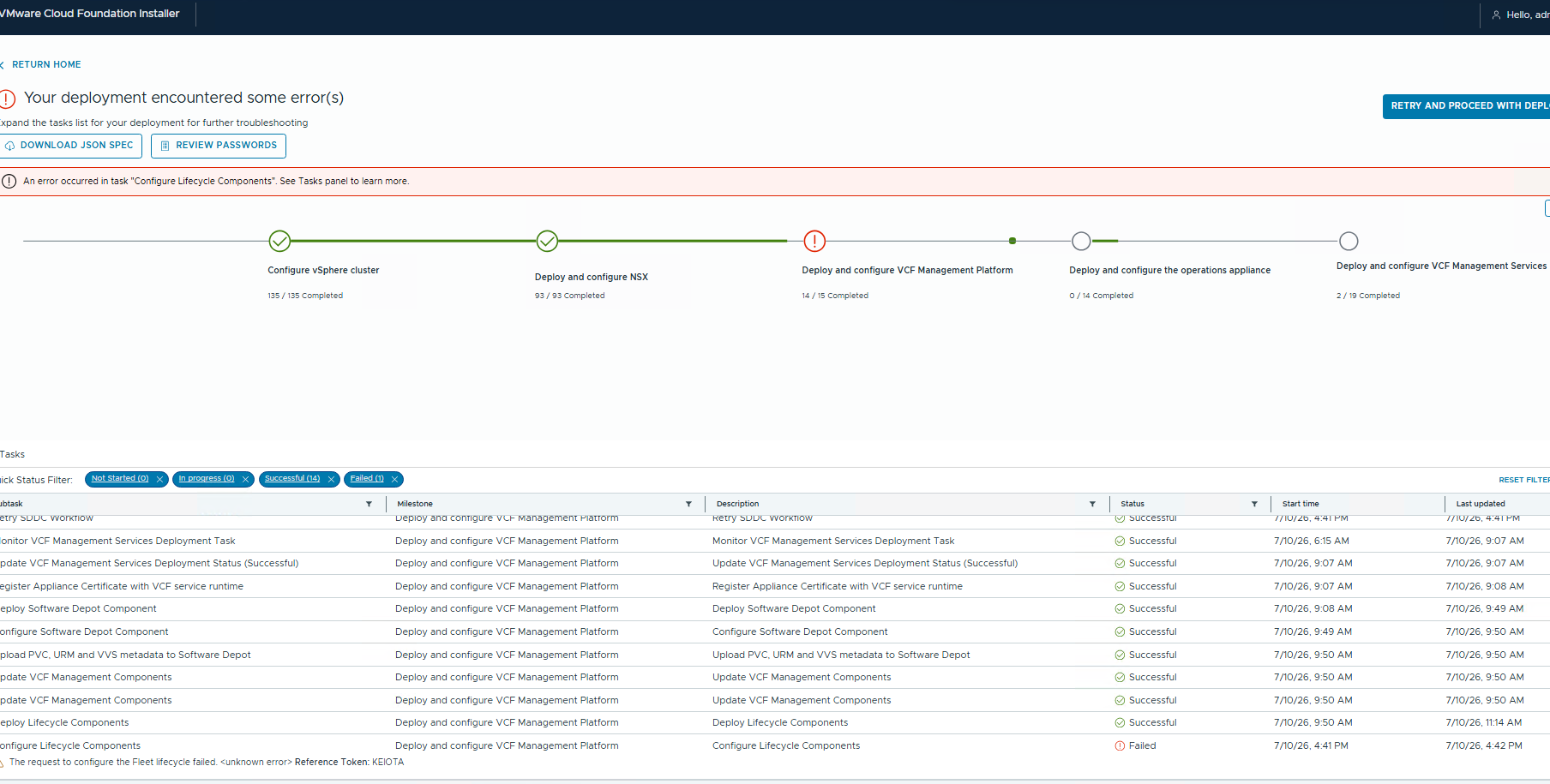

    I have deployed a Greenfield VCF 9.1 management domain. The VCF installer fails at "Deploy and configure VCF Management Platform" 14/15
    Subtask: Configure Lifecycle Components
     The request to configure the Fleet lifecycle failed. <unknown error> Reference Token: KEIOTA

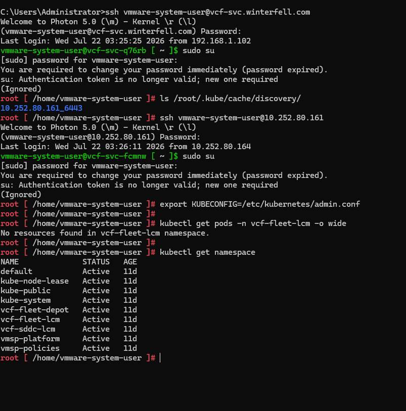

    I have followed the below as suggested thread, however it seems no pods exist under the namespace vcf-fleet-lcm. FYI it has not reached the stage to deploy VCF Ops
    Restarting fleet lcm service will resolve this failed task.
    This has been previously answered here.
    https://community.broadcom.com/vmware-cloud-foundation/discussion/vcf-91-installation-lifecycle-component-issue#bmc5fadc5e-e14d-4c2a-b405-019e9b88ec39
    Any ideas for the next steps to resolve this please?

    You are right vcf-fleet-lcm is deployed before VCF Ops and from the image you have it successfully deployed 7/10/2026 at 11:14AM,
    then there is a time blank in the UI until 4:41PM the same day show the start of the Configure lifecycle Components subtask and then the <unknown error> (ie: not even an error handled by the code).

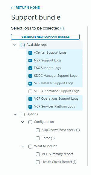

    If this is Production environment the best advice like was previously said here to generate a Fleet Management support bundle via the arrow under admin@local in VCF Installer.
    techdocs ref: https://techdocs.broadcom.com/us/en/vmware-cis/vcf/vcf-9-0-and-later/9-1/deployment/deploying-a-new-vmware-cloud-foundation-or-vmware-vsphere-foundation-private-cloud-/troubleshooting-vmware-cloud-foundation-or-vmware-vsphere-foundation-deployments.html
    I did it with fleet management select and it generated an sos tar.gz of 167MB. You can share it to Broadcom Support if can open a case.

    There doesn't appear to be an option to select Fleet Management and generate a .tar.gz file. In any case, this is a homelab environment, so I'm unable to share the logs with Broadcom for analysis.

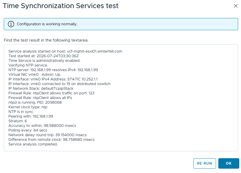

    I have checked the NTP config which is configured successfully and working on the mgmt hosts which the k8s nodes are running on
    All 4 management hosts NTP Configuration is working normally

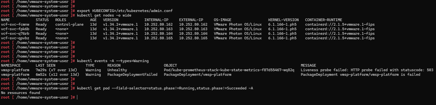

    root [ /home/vmware-system-user ]# export KUBECONFIG=/etc/kubernetes/admin.conf
    root [ /home/vmware-system-user ]# kubectl get nodes -o wide
    NAME            STATUS   ROLES           AGE   VERSION            INTERNAL-IP     EXTERNAL-IP     OS-IMAGE                 KERNEL-VERSION   CONTAINER-RUNTIME
    vcf-svc-fcmnw   Ready    control-plane   13d   v1.34.2+vmware.1   10.252.80.162   10.252.80.162   VMware Photon OS/Linux   6.1.166-1.ph5    containerd://2.1.5+vmware.1-fips
    vcf-svc-fpk6b   Ready    <none>          13d   v1.34.2+vmware.1   10.252.80.163   10.252.80.163   VMware Photon OS/Linux   6.1.166-1.ph5    containerd://2.1.5+vmware.1-fips
    vcf-svc-q76rb   Ready    <none>          13d   v1.34.2+vmware.1   10.252.80.164   10.252.80.164   VMware Photon OS/Linux   6.1.166-1.ph5    containerd://2.1.5+vmware.1-fips
    vcf-svc-qpvbz   Ready    <none>          13d   v1.34.2+vmware.1   10.252.80.165   10.252.80.165   VMware Photon OS/Linux   6.1.166-1.ph5    containerd://2.1.5+vmware.1-fips
    root [ /home/vmware-system-user ]# kubectl events -A --types=Warning
    NAMESPACE       LAST SEEN              TYPE      REASON                    OBJECT                                                         MESSAGE
    vmsp-platform   7m29s (x7 over 13d)    Warning   Unhealthy                 Pod/kube-prometheus-stack-kube-state-metrics-f87d55467-wq82q   Liveness probe failed: HTTP probe failed with statuscode: 503
    vmsp-platform   6m52s (x12 over 13d)   Warning   PackageDeploymentFailed   PackageDeployment/vmsp-platform                                PackageDeployment vmsp-platform/vmsp-platform is failed
    root [ /home/vmware-system-user ]# kubectl get pod --field-selector=status.phase!=Running,status.phase!=Succeeded -A
    No resources found
    Any pointers on where to go next would be greatly appreciated, I'm struggling to see the best way forward now. I feel like I've hit a wall with this build.

    Yeah VCF Services Platform Logs that's the name that contains infos on fleet-lcm, i did it 70 days ago.
    Anyway download the sos tar.gz for these logs even of failed deployment are valuables learning informations.
    Comparing the duration of these subtasks, deployment of lifecycle took 20min for me on nested ESXi
    Although they both deployed successfully, in your case it took x3 more times and,
    then something happened after without vcf installer UI knowledge from 11h14AM to 4h41PM on 7/10/2026.
    It maybe worth looking at domainmanager.log from VCF Installer in this time frame.
    Remember that log have time in UTC+0 so also look for the successful deployment of lifecycle.
    The warning show 'PackageDeployment vmsp-platform/vmsp-platform is failed',
    this PackageDeployment is not single kubernetes deployment but many of them using a tool called helm.
    You can think helm like linux apt, yum, or dnf, they are package management
    Because VMSP contains many resources so it's not as simple like deleting a single pod.
