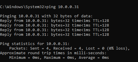

    Hi Guys,

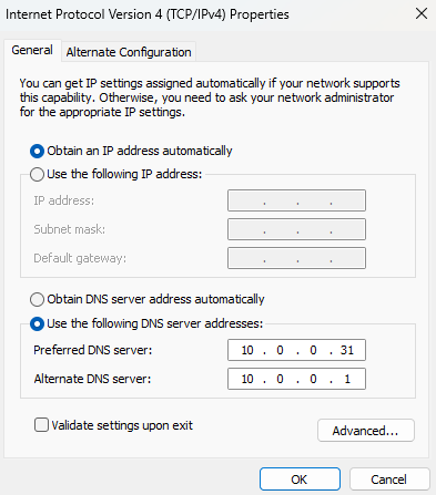

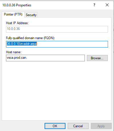

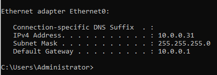

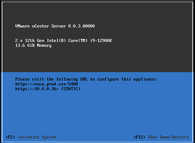

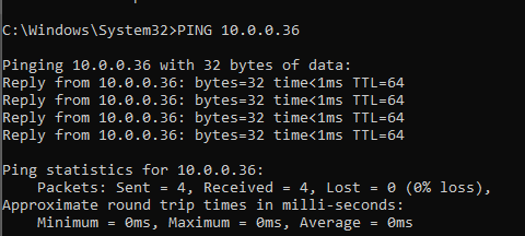

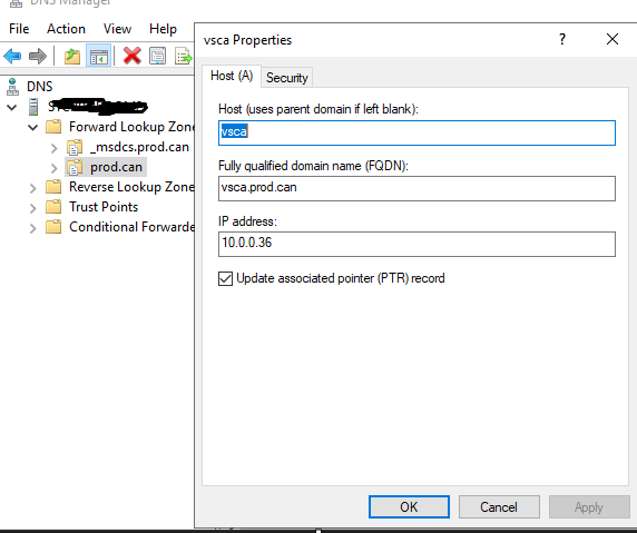

    Almost 20 days are gone and nobody is able to solve my issue. I have installed vCenter which pings fine from my PC. However, it does not open up in browser. I tried whatever I could and my friends too who are expert. But the issue remains the same. I am connected to a wifi: The details are as under:
    MY PC
    When I ping vCentre from PC
    When I put into browser
    DNS record
    Domain Controller
    When I ping from PC
    Please if someone could help why this is happening and how I can get rid of it. The PC firewall is OFF and I have uninstalled Internet security and ANTIVIRUS too, ICMP and HTTP/HTTPs rules are ENABLED.  I can be reached at pc.111@yahoo.com
    Thank you so much

    Hmm,  as this is not configured try https://10.0.0.36:5480

    it looks as if the vcenter services are not running, did you check using the ssh console login or indeed if the management page can be loaded on url : 5480 ?

    the browser capture looks like a service isn't started.
    -Also did you try accessing your vcenter on port 5480 => https://vcsa.prod.can:5480 ? connect with root and check health in monitoring (all tabs)

    The screen shot says the appliance is not configured, connect to it on port 5480 to configure it.
    they have only deployed it but not completed the second half of the deployment where you configure the appliance.

    Guys,Thank you so much for your help. I got it configured. I reset all firewall inbound rules to DEFAULT. Then I executed both commands. After that, I was able to access vCentre in browser.
    service-control --stop vmware-perfcharts
    service-control --start vmware-perfcharts
