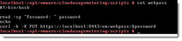

    I discovered a not so obvious caveat that some users may unknowingly encounter when using the webpass script properly. The issue involves the use of special characters in the password you select for the admin account.
    Let's say for example you login correctly using the usgmtr account and whatever password you setup originally when you configured the appliance. You then type webpass and choose a password like "sun$moon" (without the quotes). You will not receive an error, and you will not be able to authenticate via the web page when using the admin account as you might think. The reason is the "$" symbol is passed to the cURL linux command, which when used in this context does not pass the "$" character correctly from the shell variable or does not pass the full password you entered because the "$" has a special meaning to bash when used as shown below:
    The problem is related to how the bash shell processes the script as shown. VMware should be able to fix this fairly easily with back-quotes, quotes, an escape sequence or some other method which I don't have the time to figure out at the moment. :smileyhappy:
    When I replaced the "$" with a "." for example, it works no problem. There might be some other esoteric symbols that will cause a similar problem, so YMMV. I only know for a fact that using the "$" WILL NOT WORK in version 3.4 at least and probably all the way back to at least 3.2.
    I have included a screen shot of the latest version of the user documentation for version 3.4 as of 9/30/2015 below, which is where the documentation note should be added.
