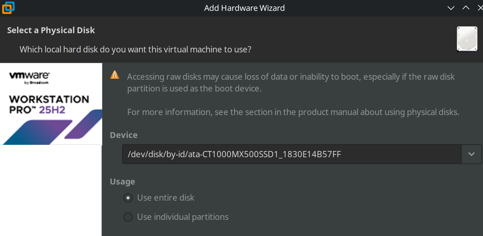

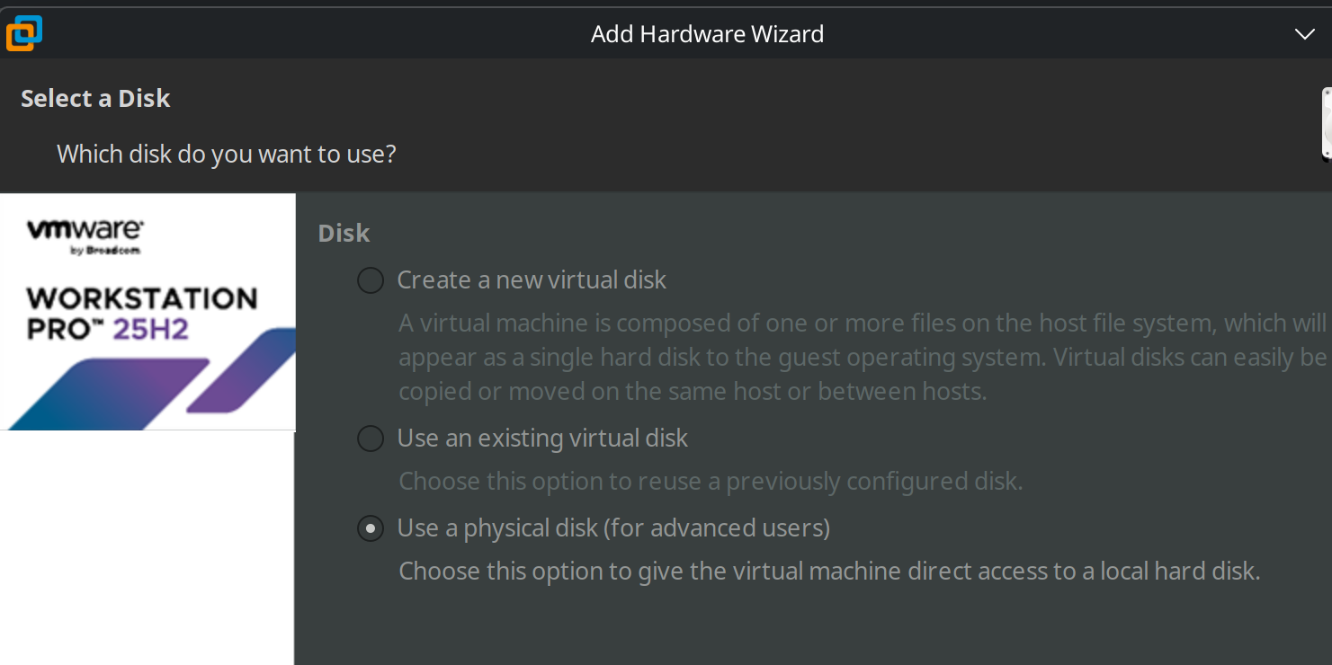

    OP: None of the above.  Assuming you want to pass the entire drive through to a VM [as a raw block device], you don't need to format it.  Omit it from fstab as it won't be mounted on the host.
    In VMware Workstation you'll add as a physical disk:
    Enter the path to the device (this example has the ID for one of my disks -- yours will be different):
    Inside the VM you'll now have a new drive which you can partition and format as-needed.
