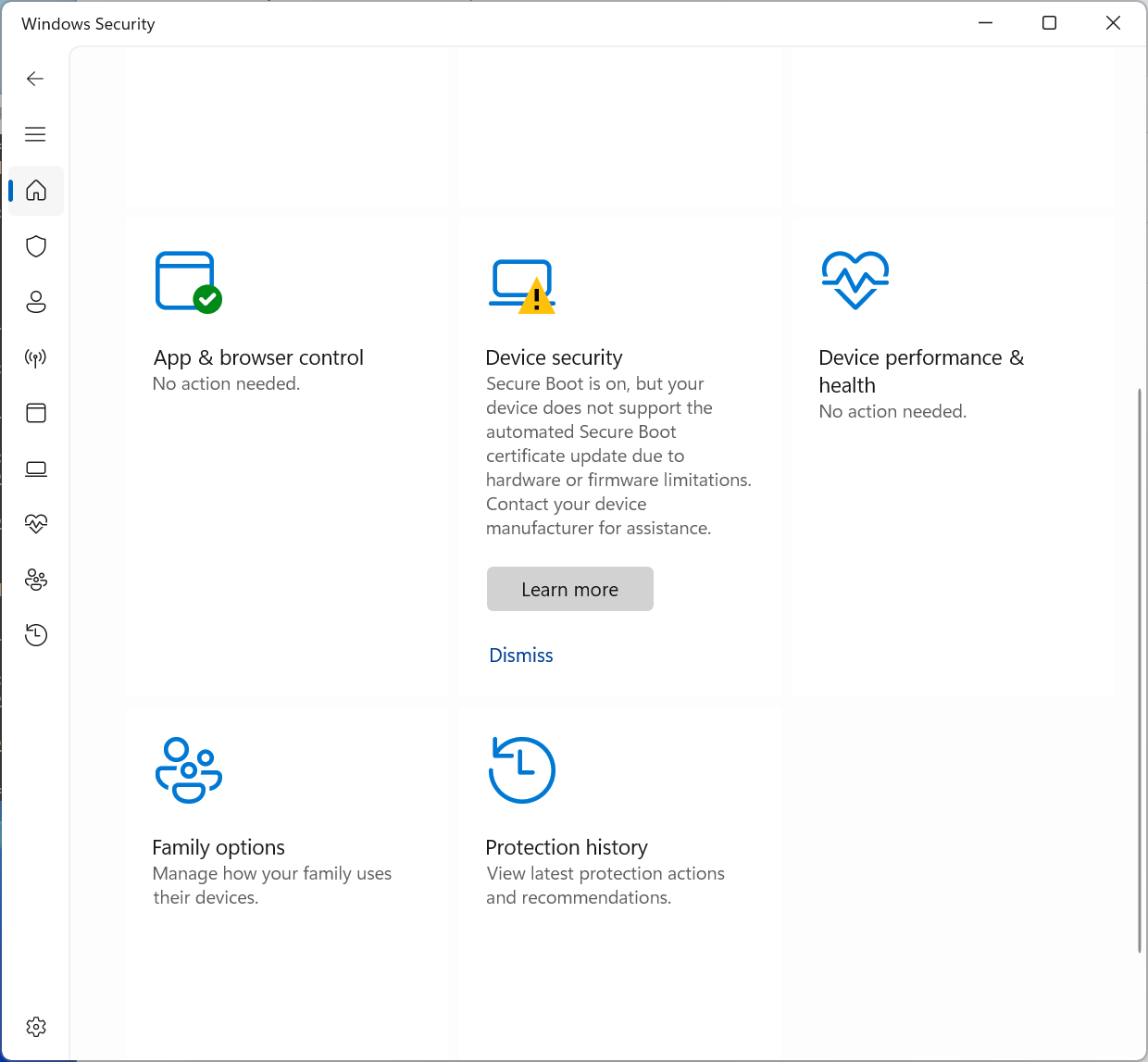

    Running a Windows 11 25H2 Guest (on a Windows 11 25H2 Host) with the June MS updates shows the following complaint in the Windows Security section.
    Basically, it seems to say that the system doesn't support having it's Secure boot certificate updated for the upcoming removal of old secure boot certificates.
    It points you at Windows Secure Boot certificate expiration and CA updates.
    Is there a way to get these secure boot certificates updated for the Guests? I assume this really relates to the Workstations virtual  'UEFI Bios'.
    (This is using Workstation 17.6.4 on the Host.)

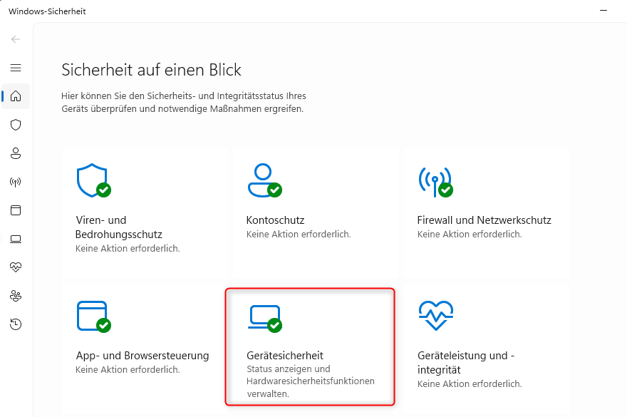

    As I read your reported issue, immediately I checked it on my end. Honestly I didn't used the check box for "Enable secure boot". THen I set the checkmark and after starting my VM (Windows 11 Pro) I couldn't see any difference from the situation prior.
    The two images reflect the situation on my system.
    I'm also using Windows 11 25H2 Guest (on a Windows 11 25H2 Host).
    Unfortunately in German
