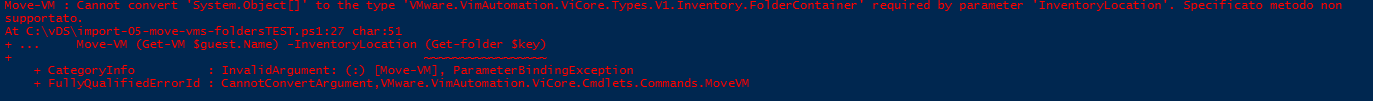

    I got below Error

    Looks like something goes wrong with your Import-Csv.
    Do you have blank lines in your CSV file?
    What does this return?
    Import-Csv "f:\vms-with-FolderPath.csv" -Delimiter "`t" | Sort-Object -Property Path

    Ok, you changed your CSV file content from what you originally showed (Tab-delimited fields).
    This should return the properties correctly. Can you give it a try?
    Import-Csv "f:\vms-with-FolderPath.csv" | Sort-Object -Property Path

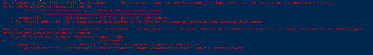

    I used Cheap DR script , but receive this error when try to move VM to Folder:
    The output csv file created with Cheap DR Script is writed in this way:
    Name,"Path"
    vSphere Management Assistant (vMA),"CED Production\MGMT\vSphere Management Assistant (vMA)"
    As you can see, i've folders and vms with blank space into name.
    Thank for all...
  • 18.  RE: Script for Move vm from one folder to other folder
    Posted Jan 22, 2019 11:33 AM
    Script export-05-vms-with-folderpath.ps1 should create the CSV file.
    Did you run that?
